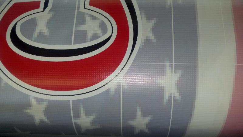

So using a simple Jpeg from internet on a banner. Not worried about it being crisp and clean. It's a back ground filler on a banner. How ever when printing it Flexi seams to be putting blank lines in it. Look at pic, any suggestions on how to fix. This JPEG is 35% Translucent Lens done on it.

Never seen that before.
To fix it I would open the JPEG with PS, re-size it to the actual size, then add the transparency & flatten it again (save as JPEG). Then, load it into Flexi.
Only way I can explain is that it's in the .jpg. Like someone put a layer on top so you cant print it. When you zoom in on the .jjpg in flexi really close are the lines there?
So your problem has nothing to do with flexi. It's the .jpg that your using. Try a different flag background. This happens ocasionally where when your zoomed out looking at something in flexi it all looks fine. Then when you go to print you notice gaps where theres not supposed to be gaps or weird dots. It's just the way flexi makes objects look when they are zoomed out. You need a new background or you have to go in and fill all those lines yourself.
Your other option. Make it as big on the screen in flexi as you can without seeing the lines. Then take a screenshot. Paste that back into flexi and use that.

Thanks guys for all the advise. This is a temp banner for some congratulations thing. They sent the Jpeg from internet and this is the one they want. Or I would buy a Istockphoto and do it up right. Sometimes u need to just give the customer what they want. They are one of our BIGGER customers that do a lot. They want this banner done this way and want it almost free. LOL But I think i fixed it by taking into Photoshop re-sizing then bringing into flexi.
sometimes this happens in flexi when you take a low res image and try and make it a larger or higher res image, the lines appear. it has happen many times to me, and not with just web art, but art that was to small to be blown up to as large as i needed it to be...

At the very least, open that low res image in Photoshop, apply a blur to it. Even though it's not a focal point, it at least isn't all jagged. I do it all the time. From 20 ft away, your eye sees what's there.
