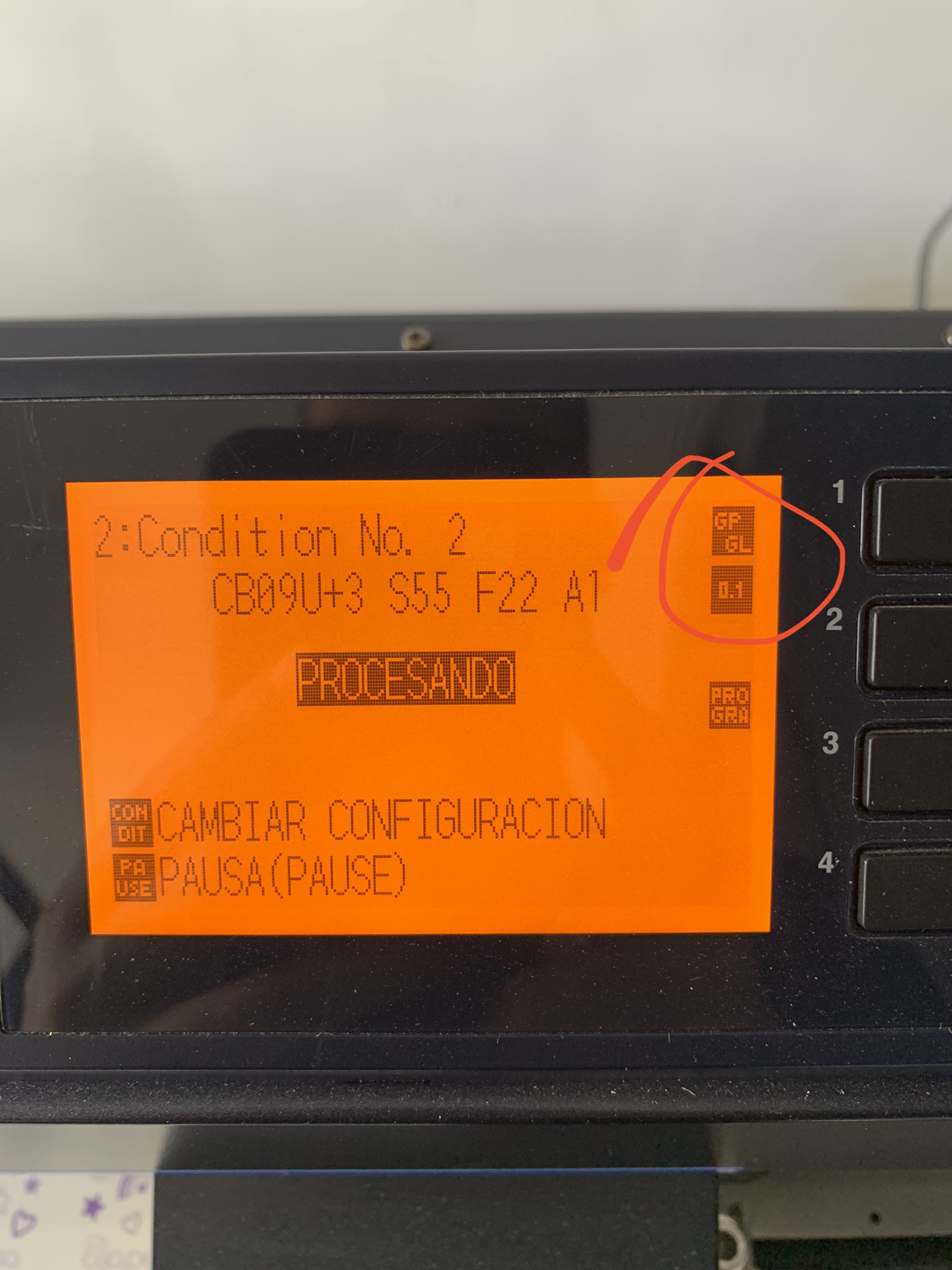

Costaricanprinter
You need to set up the command to gp gl
I have te same problem when I sent cuts from Flexi

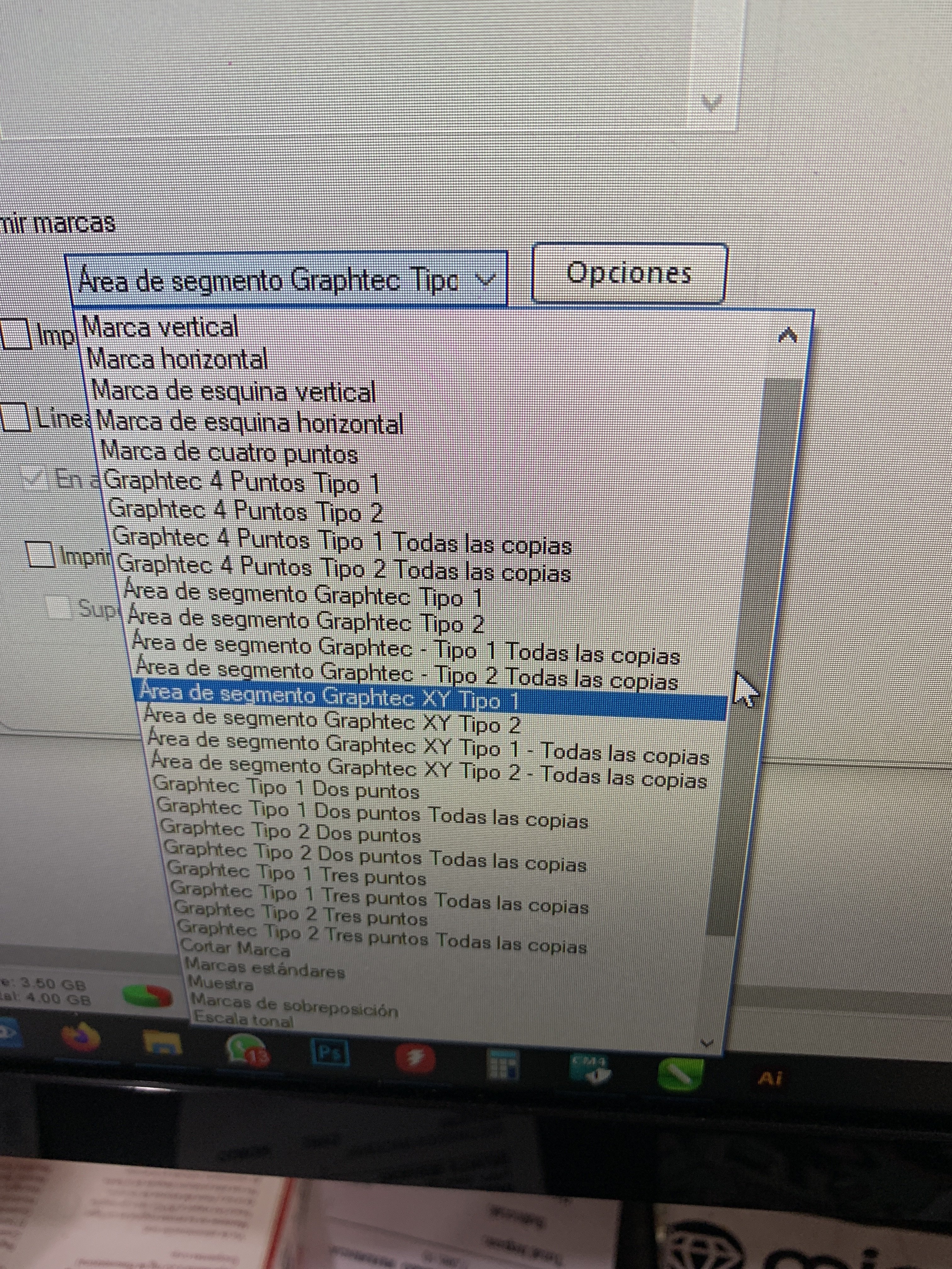

Costaricanprinter
The barcode only works for me using CM4 on Corel draw , on ilustrator put the bar code in a diferent position and the plotter don’t read it
Had try all the cut marks this one is the only one my plotter read and cut perfectly, on Flexi 19 mutho edition
Sorry for my bad English , cheers from Costa Rica
