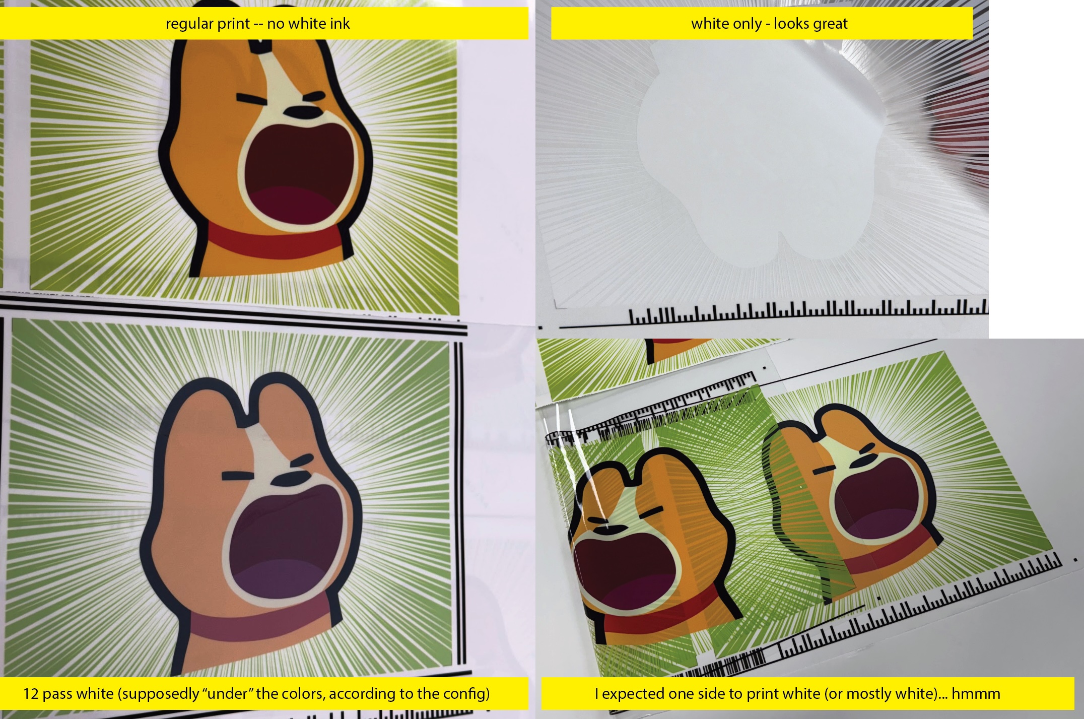

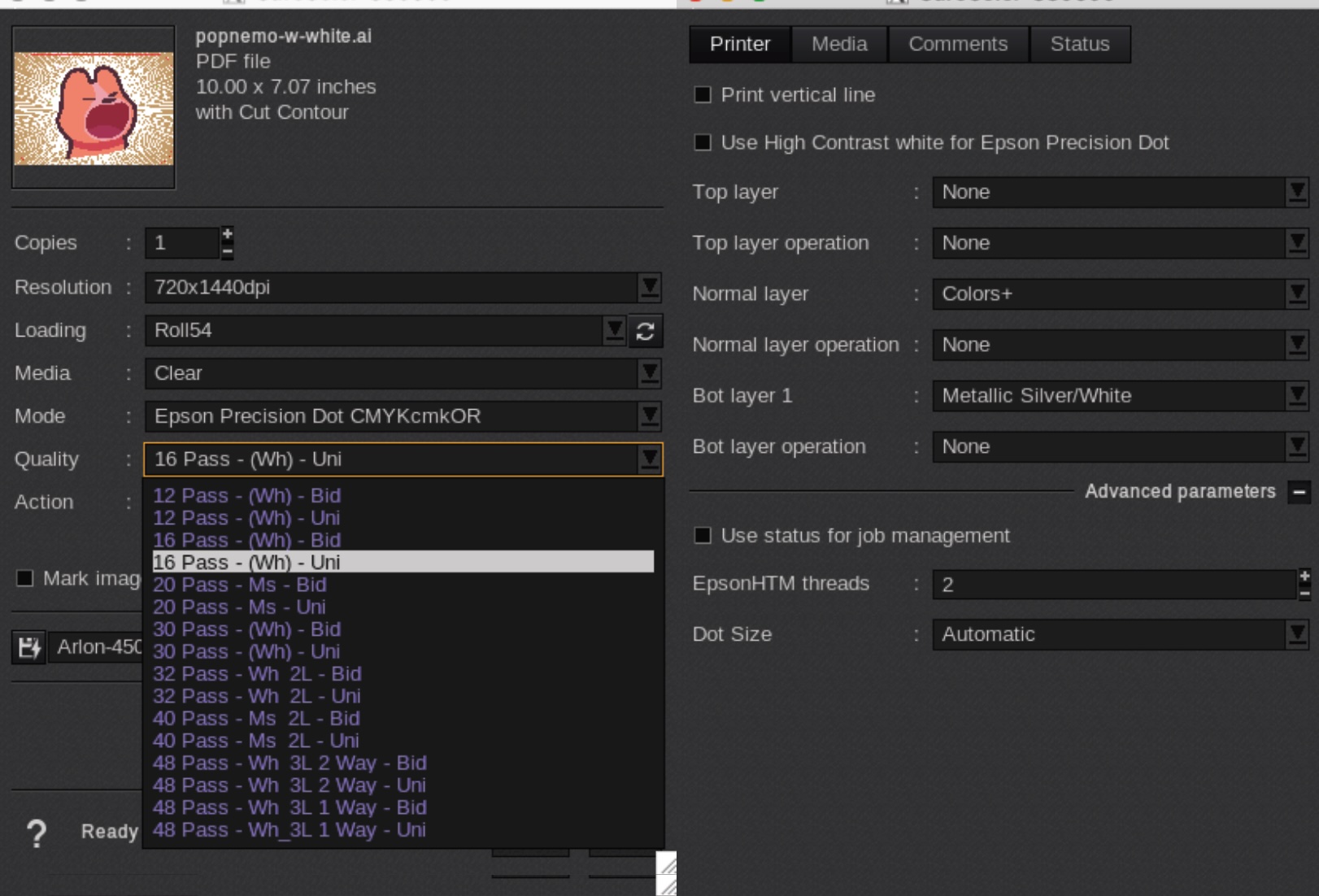

I created a custom profile for it (I have a spectro), but wasn't sure how many passes to make. I just went with 16 for a quick test. Pure white is fine -- but the output (with color) sort of mutes the colors. It's certainly more opaque, which is good, but the vibrance is cut by at least 1/3. Should I up the number of passes? (not sure what those "2L" and "3L" specs are in the profile settings.
How many passes do you guys run if you're printing color on top of white?
I don't mind making another profile -- but for those of you who own an i1 Pro -- you know how much scanning swatches sucks. lol

We use the most of the time with white as a base for colors 24 passes and the most times it is fine but we have some jobs that require 48 with double the amount of white ink.
