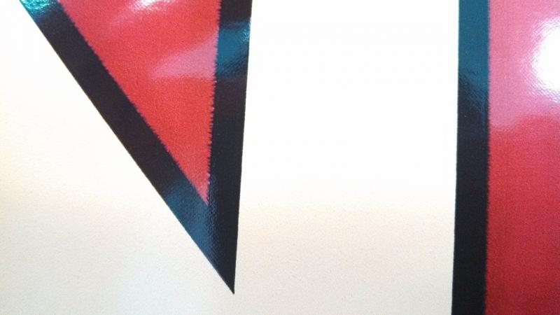

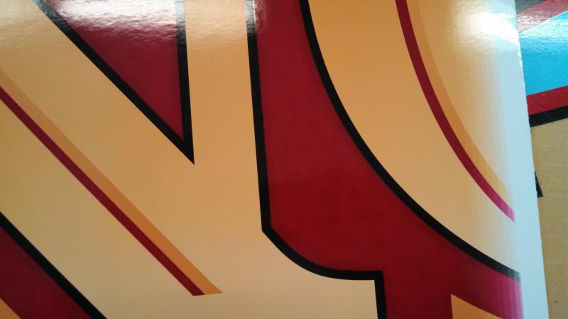

I'm having a hard time printing a job. Printing on 3751ra on my xj540 proiii using versaworks and a certain spot color ( all vector art saved in illy as .esp). I have noticed before some spot colors print great while others just don't. I try not to depend on spot colors for this reason. Today the offender is ST41k against black areas which is BK22A (I always use spot black because it gives best results for us). Where they meet the edge is not crisp it is "fuzzy" and IMO not exceptable. also the Burgundy (ST41k) is also blotchy looking. Does this happen for anyone else using the rvw spot colors? Is there anyway to going and fix this? I have very limited knowledge in profiling and i normally use canned profiles and get pretty good results IMO. i have tried using a different profile, have tried printing unidirectional, messed with heat settings, messed with dither and color management presets.... nothing seems to help other changing the color to a process

petepaz
looks like a heat or material profile issue. we have vp540, xc-540 and xr-640 and when we have had similar issues it was a heat or material profile problem. either the heat was off or too low for some reason or they used a generic profile. we use glossy calendared vinyl and matte calendered vinyl profiles on oracal 3651 and 3164 they print ok for us. also i have been trying to do most prints on matte vinyl if possible seems we get a better output.

Yea I agree 100% with matte printing better i think it is because the gloss media takes longer for the ink to penetrate. But I have messed with the heat what not and didn't seem to make much difference, I just ran some more prints matching the burgundy using RGB and am going to run this job with that as the van is being dropped off in the morning. It seems as if it may be the black that is not crisp idk... I print 3751 a good bit and for the most part never have an issue.

On the red/black though... Looks almost like the colors/ink is bleeding together? Maybe the heat setting?
SIGNTIME
The reason I think it has to do with the spot colors is if you notice in the close up picture where the burgundy and black meet it looks terrible and both those are spot colors but where the black meets the yellow its nice and crisp same as where the burgundy meets the yellow, those yellows are pantones. I am thinking that the spot colors are laying down more ink causing that jagged edge. I will have to do some more test prints and try slowing down the head speed see if that helps I guess.

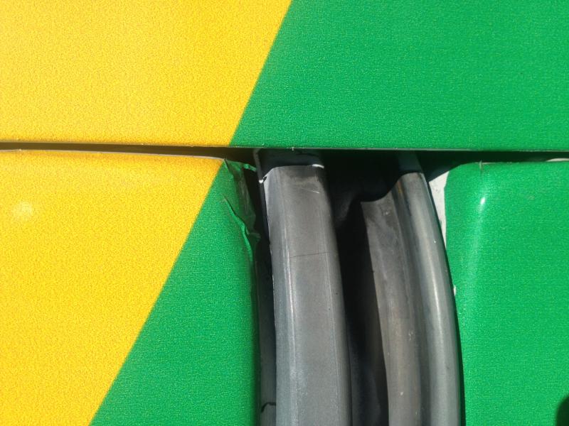

CES020
I took this photo of a wrap I saw the other day. I didn't wrap it or print it, but it looks like the same issue you are having.
The photo got rotated, sorry about that.

I ended up just matching the color in rgb and it solved the issues I was having. It seems that while some of the RVW spots print very nice other do not in this case VW was telling the printer to lay down to much ink. Is there a way to edit the Spot colors in VW? I do like how with most of the RVW spot colors there is very little to no graininess and how it eases the color matching process.
