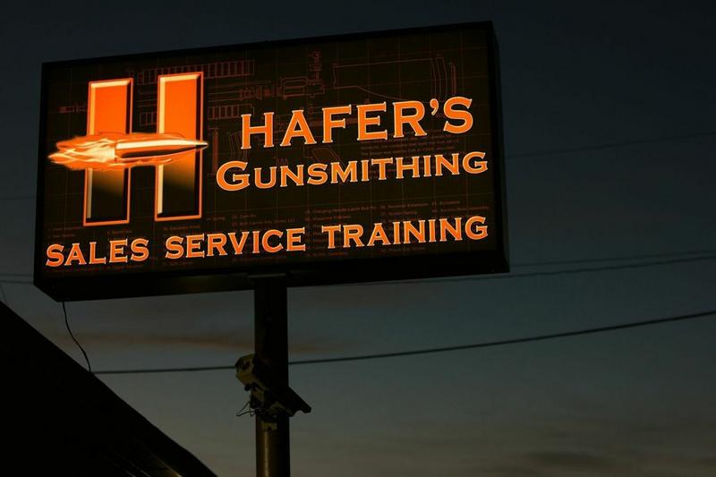

My first trip out with a big squeegee was a pair of 4x8's for this lighted sign. Thank you big squeegee.
