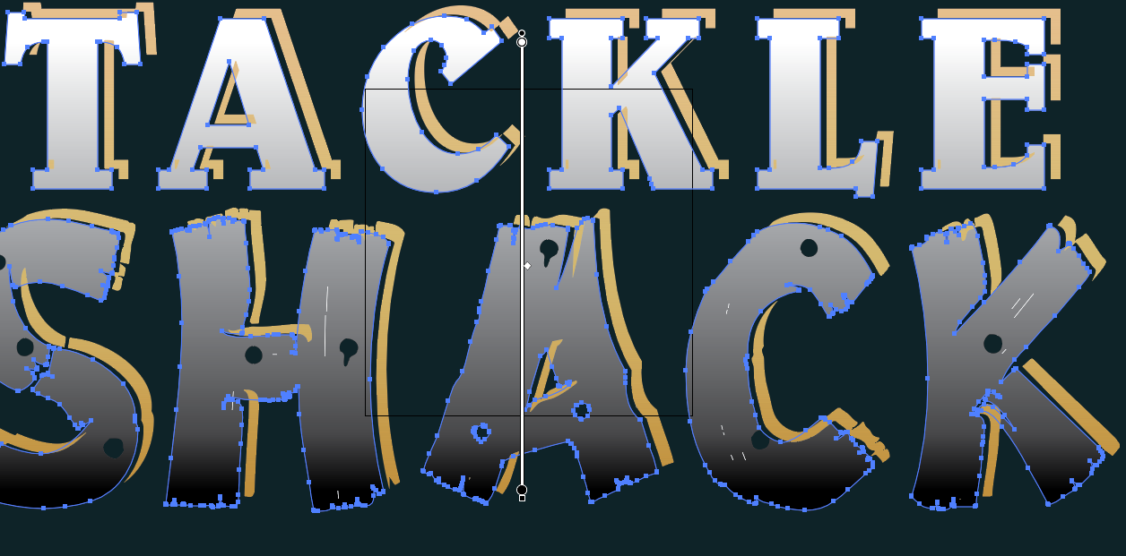

Actually on the EPS logo the paths are intact. Everything is connected from what we can see here.
One control handle effects the shape of the curve on the outside of the logo.
