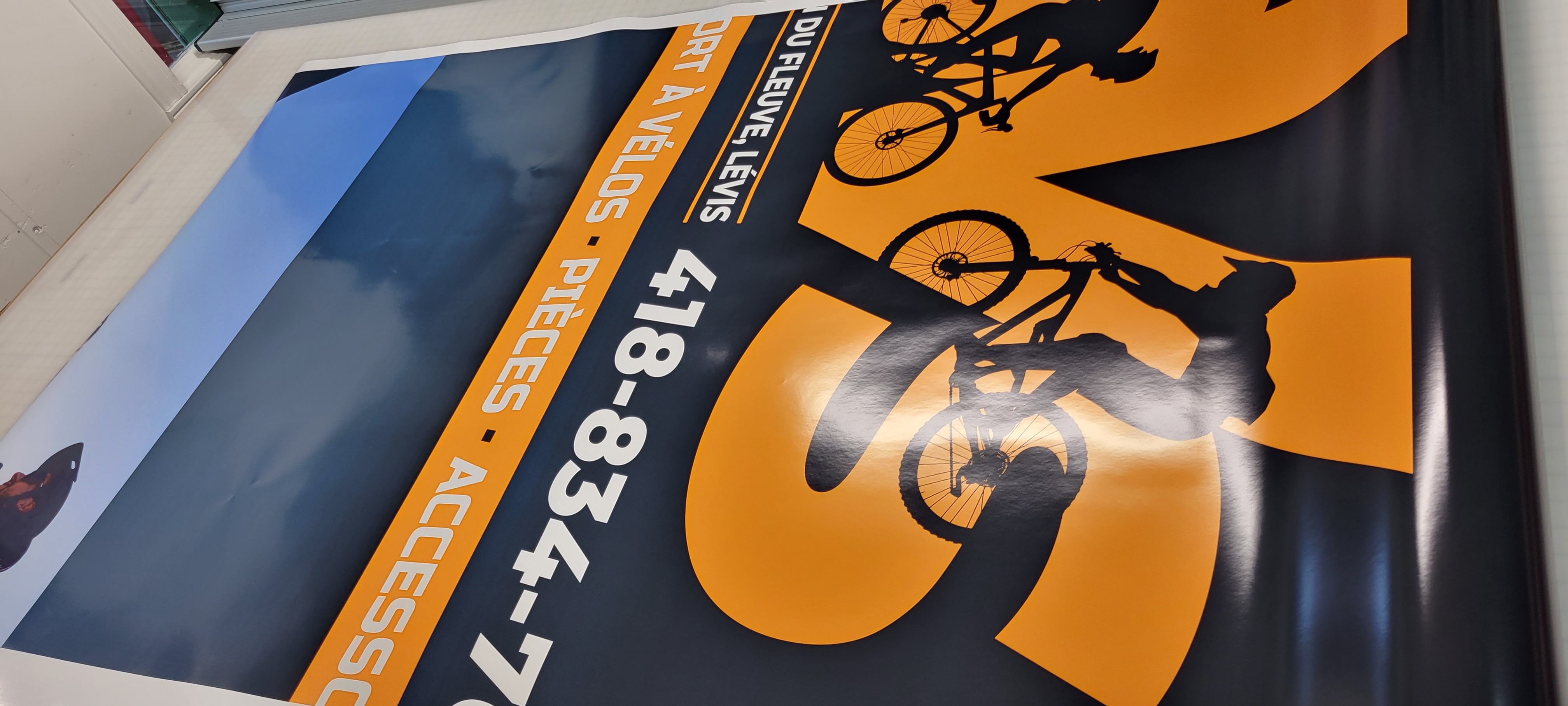

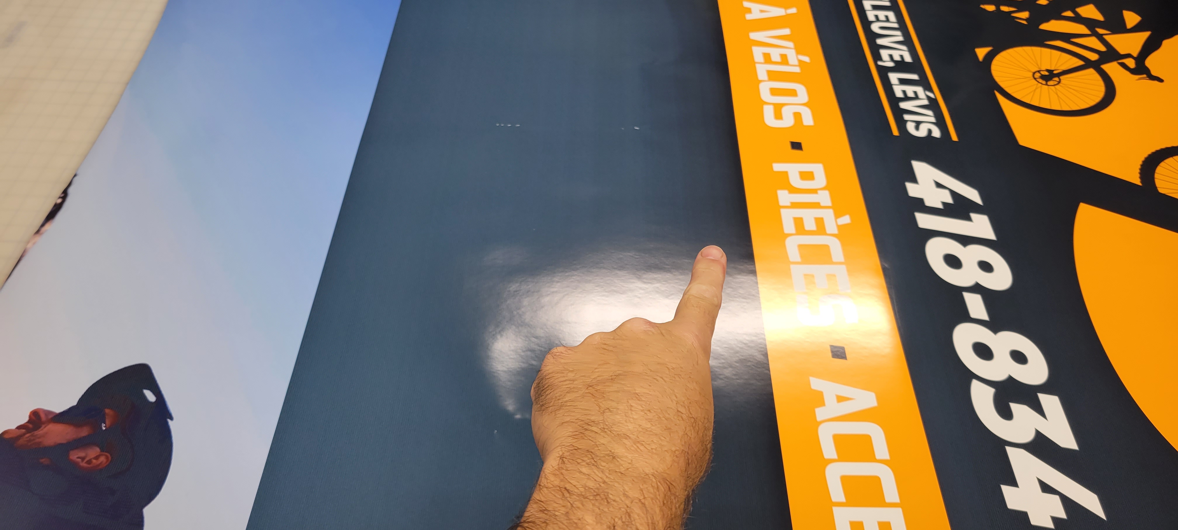

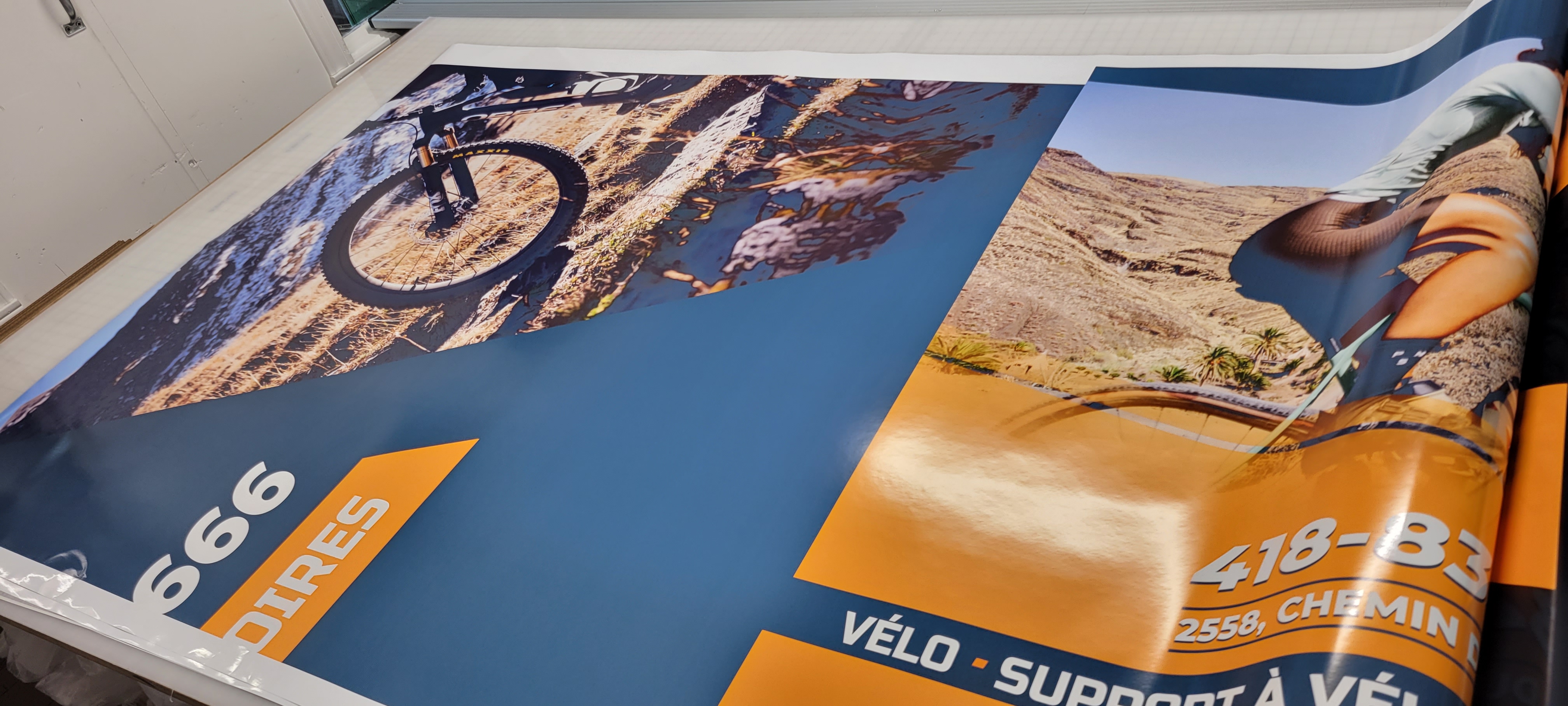

I have a new Mimaki JV-100 from july, everything is ok but from a week, black color problem.
When I print with a full black print, the black disappears...

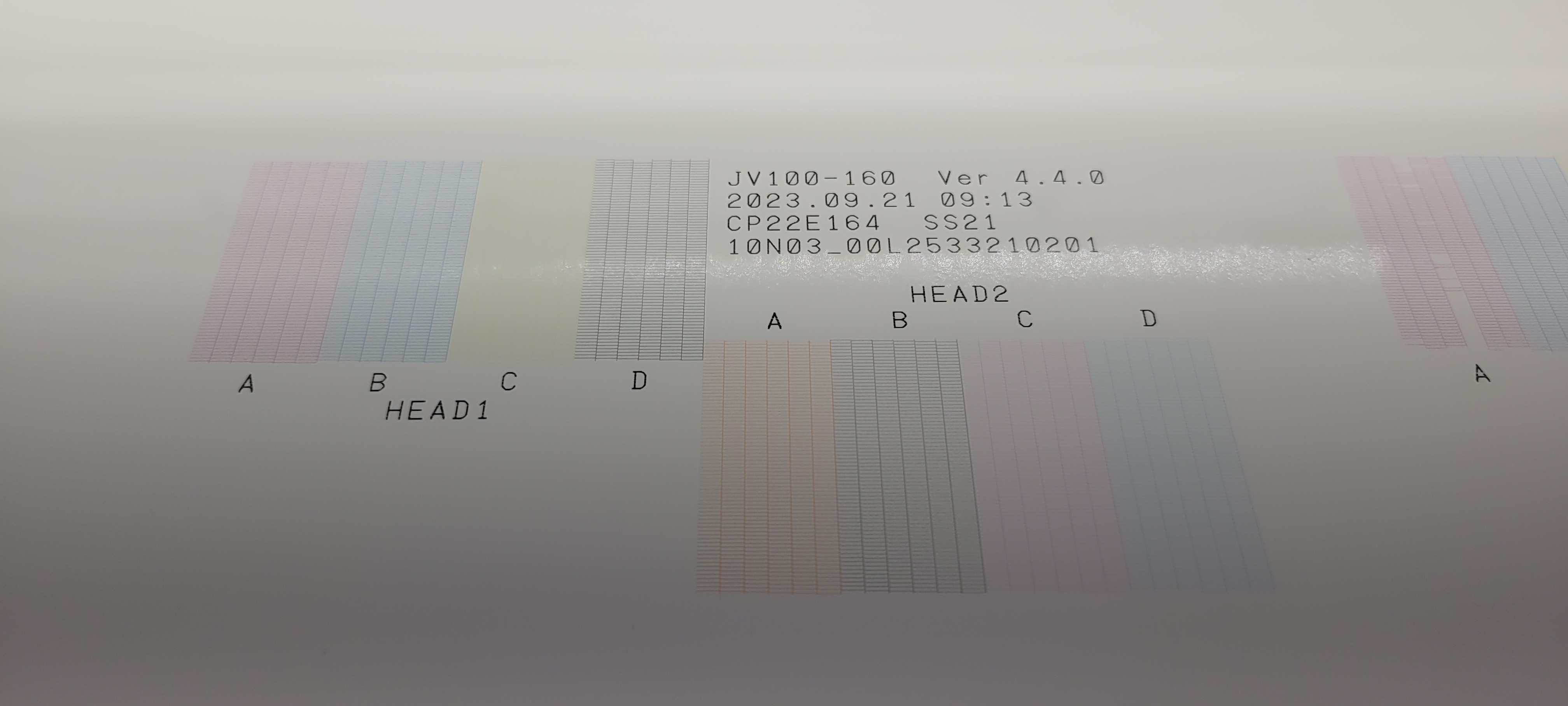

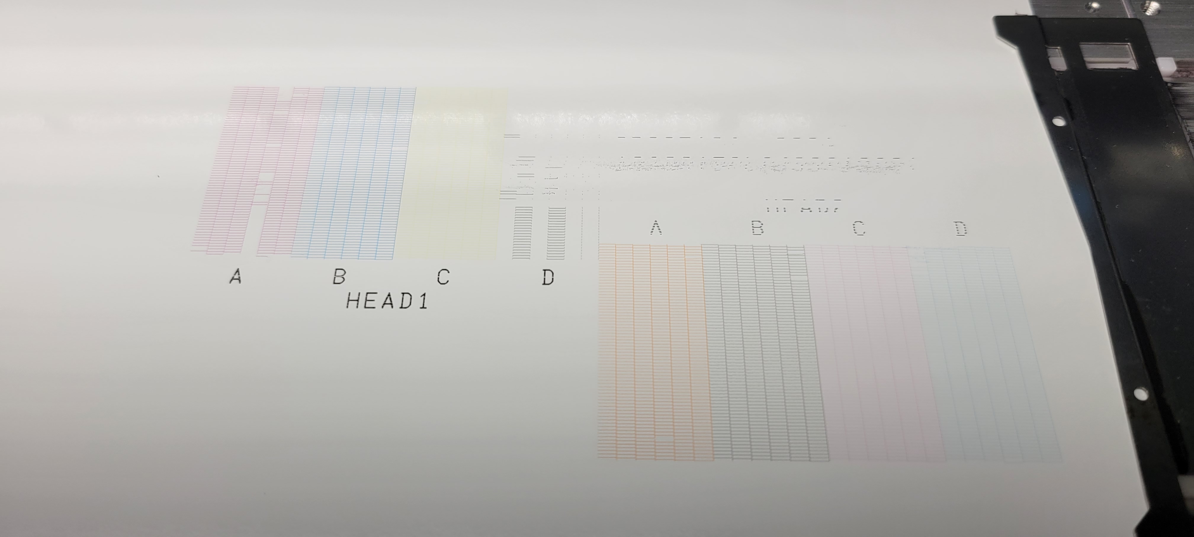

I take a picture of the test print before and after soft cleaning... 20230921_090029.jpg 20230921_090039.jpg 20230921_090116.jpg 20230921_090516.jpg IMG_20230921_091330.jpg
The problem was in the back at the begin of the line, the quick plug was leaking, I removed it then connected the line directly to the cassette...
