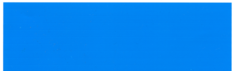

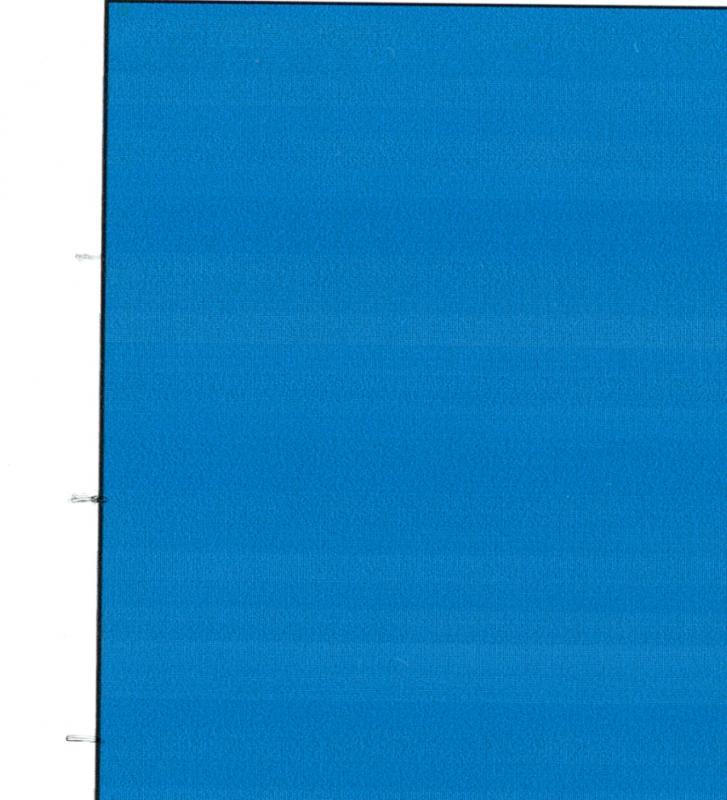

when we do a test print all colors print just fine but when we print we get banding in the cyan as seen below any suggestions
Note each one of the pen marks on the left are 1 inch apart. the attachment is smaller

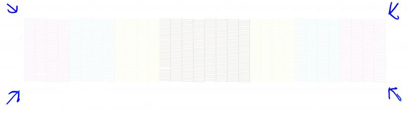

here is the test draw
and here is a function ->test cyan @100%

the test was done in uni 5 pass the original was bi 12 pass and it really fluctuates how bad the banding is from one end to the other of a long job I just did a test with the other colors and the Feed comp seems fine on them.

It's possible you have nozzle deflection. Ink comes out but not at the correct angle, causing banding. Some of the more advanced printers can adjust for this, but on the JV33 the only way to fix this would be to replace the print head completely.
