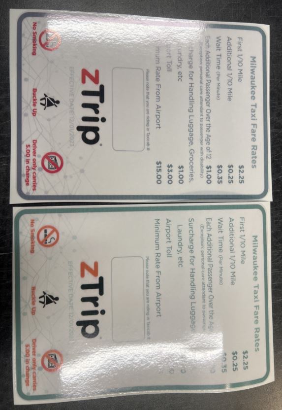

I am using a Mimaki JV150-130 printer and I'm having issues with the color fading as the images print, especially the black/gray. The printed images start close to the desired color then as they print they gradually fade. The border and text on the image attached to this post should be 50% black, but it is fading to an ugly green. The printed image at the top is close to what it should look like (especially at the bottom of the image where the print starts) and the image on the bottom is what it looks like at the end of the sheet. I am printing this image on 30 in. wide clear decal vinyl image arranged 4 across by 3 high.

Fading during printing is usually going to be an ink flow issue. I'd start by changing the dampers. They are responsible for keeping ink flowing to the head during printing.

Why isn't the color changing on the "trip" in Ztrip or the buckle up logo? I know it's probably 4 color k but If the black was truly running out wouldn't those two show degradation too? I'm on mobile so I can't see the pic that well. What RIP are you using? How many up are you running?
I was wondering the same. I used "Immediate Print" Each image is about 5" x 8" in size and I tiled them 4 across by 3 high.
