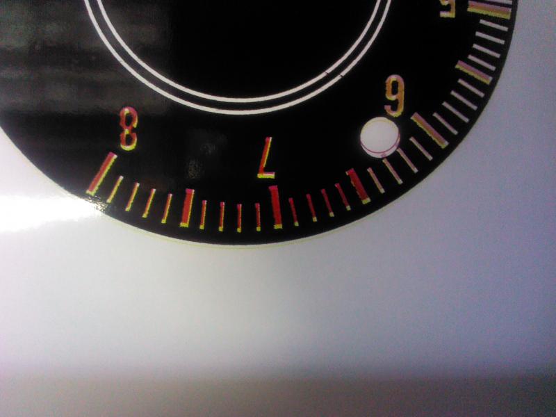

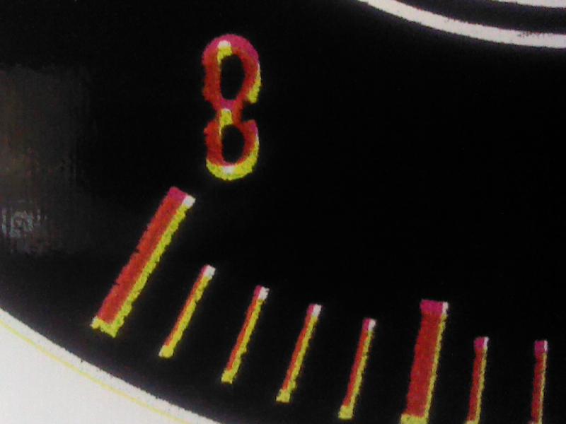

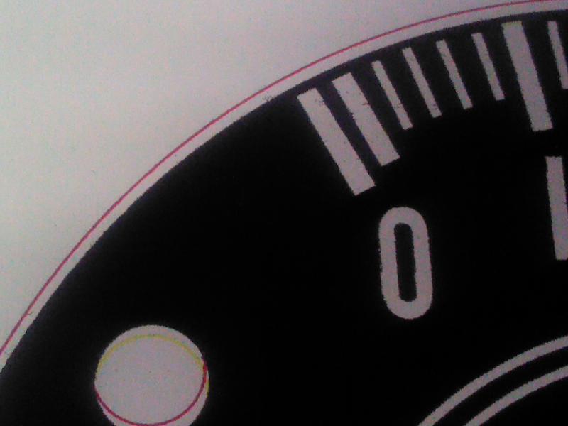

I have enclosed some pictures of decals which we are trying to print, but the colours are offset.
It looks like calibration, but test print (in test menu), head adjust, prn.adjust2 look good and now have done 3 sets of recalibrations.
The calibration I've done are in this order,
head adjust, slant and unit,
print adjust2 Y base
print adjust V1, y si, y re, y bi, fine y si, fine y re, fine y bi
print adjust V2, y si, y re, y bi, fine y si, fine y re, fine y bi
print adjust Nor1, y si, y re, y bi, fine y si, fine y re, fine y bi
print adjust Nor2, y si, y re, y bi, fine y si, fine y re, fine y bi
Print adjust x
Maintenance print adjust
Is this the right order? What did i miss something?
