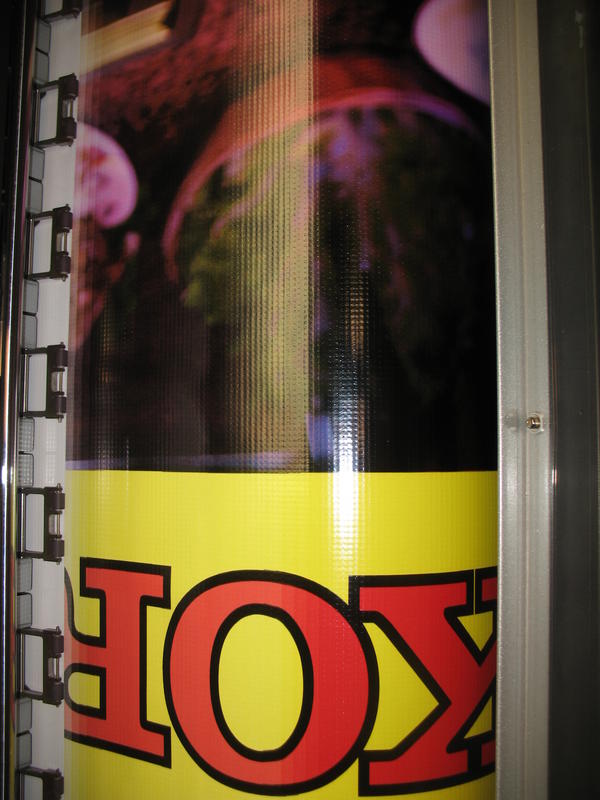

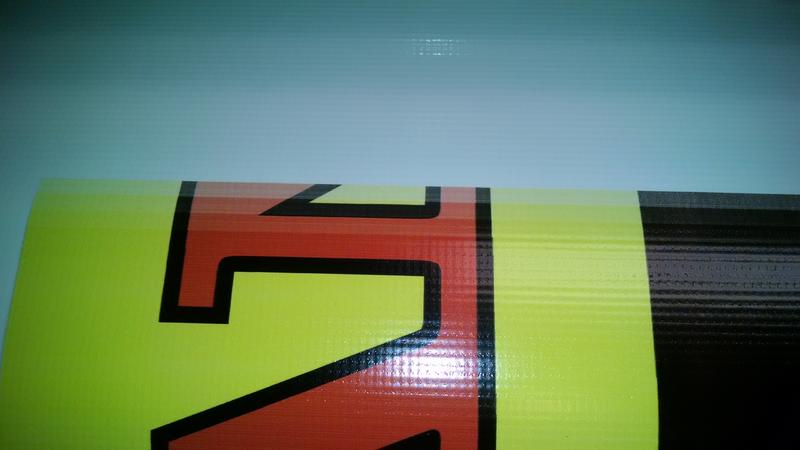

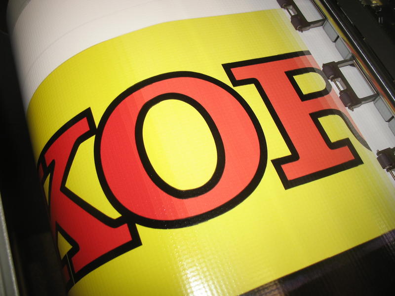

It started messing up right after I said....hard to get a picture maybe just the red is dropping off but when I came in here last night the printer was going across printing nothing about halfway through
tooserious
IT totally stopped again ........no ink whatsoever...........wow???????
It was printing subdued colors and then nothing?????

Dropping all colors at once is almost certainly an Encoder problem - there's really no ink system or head data issue that could account for them all disappearing at the same time.
Check the cable from the Encoder Sensor and see it there's any damage to the wiring. We sell sensors for this machine if you want to do a swap out. Also check the HDC Cables (the big wide ones that tun from the slider board to the main board) for damage. There's a track on one of these cables that carries the encoder signals (though I can't tell you which cable exactly).
Have you tried running the Encoder Teat in the #Test menu to see if it passes or fails?
