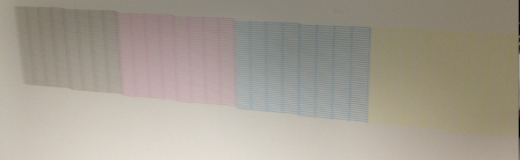

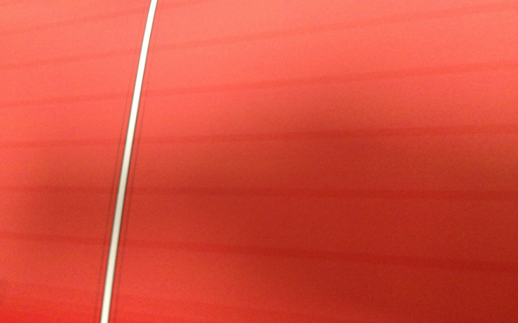

-tail-end of a large project, and magenta starts printing 25% on 12/16 passes.
--cancel print, run test draw, nozzles @ 100%

-now 0% nozzles firing on test draw on all channels!
:frustrated:
nozzle wash, fillupink, test draw...same thing, nada.

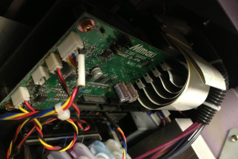

I pull my ribbon cables out and notice that, at the slider board, the top cable is slightly kinked (#1/5). closer inspection... crunchy to the touch, I don't know how or when (most likely during damper swap) I must have pinched the ribbon cable?
--unsure if it is the cause, but IF it were kinked/connection severed... is it safe to think this could be the cause of printer running as usual but simply not firing ink whatsoever? no errors, all operations per usual, just no ink firing...
attachment.php
debating pulling the cable and running to radioshack to see if they either have another one, or they can shorten/strip the one I have.... but want to make sure I'm not too jaded to consider other options before "major surgery".

vinylbytim
Try swapping the cables from the black to the magenta and try a test draw to confirm. I have had that happen and it ended up being the head cables being worn. But that does look like a nasty crease. I have a few parts printers if you need any parts.

MikePro
confirmed, not the "kinked" sliderboard ribbon cable.
disassembled the printer and luckily there was a 6th ribbon cable run through the printer that was connected at the motherboard, but not connected at the sliderboard-end. swapped #6 with the kinked cable at the slider board and motherboard-ends and still same dilemma:
-printer fires up per usual, goes through the motions of test print/chkpattern/regular print but does not fire ink as it travels...
heads look pristine, nozzle washes do nothing, best I can assume the issue is data/electrical.
