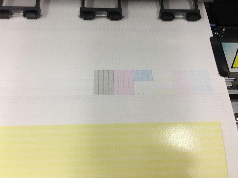

I think it is a capping station issue. Tried a manual draw on Friday and I heard air coming through capping station on head #2, leaned on carriage slightly and tried draw again. I had ink flow when pressure was applied to carriage. Working to find my issue's source. I have a spot on the print test draw that is missing and a spot that's angled nozzle. Loooong head soak necessary?

yeah, do a long soak to try and clear that up.
as far as your capping station is concerned, try bumping the cap upwards a bit for a tighter fit when parked.
last time I did this, I just ran a nozzle wash, and when the carriage moved out from the capping station I removed the black rubber cap from the capping station and reseated it with minimal pressure. (I don't know if you have the aftermarket-type of caps, where the black cap is not removeable, but if you do then you should still be able to to pull it up slightly...i think)
once the cap has been shifted upwards slightly, finish setting the nozzle wash and the head should make a firm connection against the captop once again, and will cycle the ink properly upon completion of the wash.
