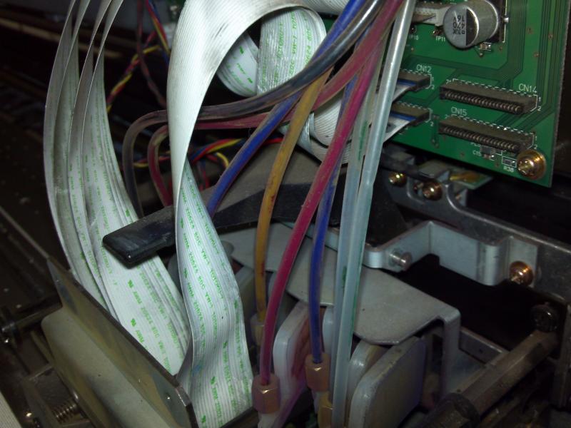

I am on with fitting a head height adjuster on My jv3 160s which was missing when purchased. Does anyone have a picture of how this is mounted? I have searched for hours and not found a single Image. The mechanical drawings for this machine are no help either.

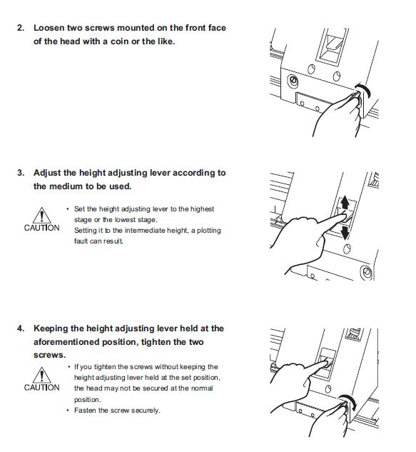

Are you talking about the head adjust as shown or was it removed from the printer carriage?

Take the head cables out of the printer with the machine turned off, unplugged and discharged. Also unscrew the two head lock shafts (black plastic with flat head screw tops) completely out. You will see two screw holes that do not have anything in them that match up with the metal bracket that holds the lever. There are two rectangular indents between the screws that match up with the protrusions on the back of the lever. Place the protrusions in the rectangular indents and tighten the screws. When you push down on the lever it should raise the head carriage up slightly. If it does, put the head lock shafts back in and you should be good to go. Sorry for no picture but this is the best way I could describe it.

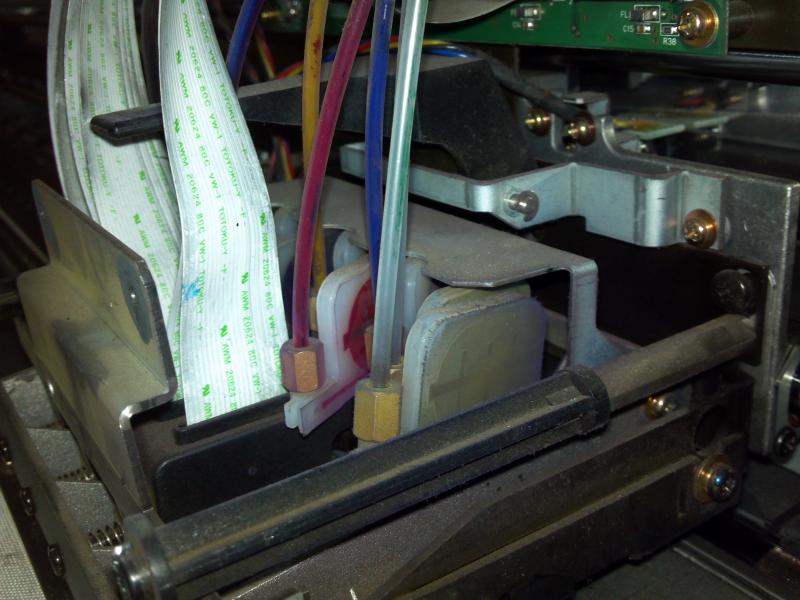

Auburnpeanut
Hope these pics help. If you need more, let me know and I will try to get better ones.

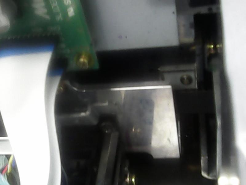

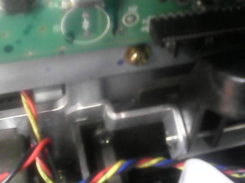

heyskull
Here are some pictures. (not he best quality)
It is as if the metal bracket is incorrect.

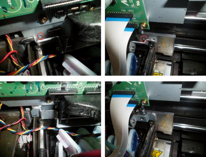

heyskull
Here is some better pictures.
You can see the holes on the top pictures circled which are not in the correct place.

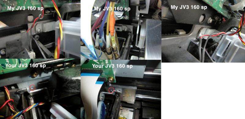

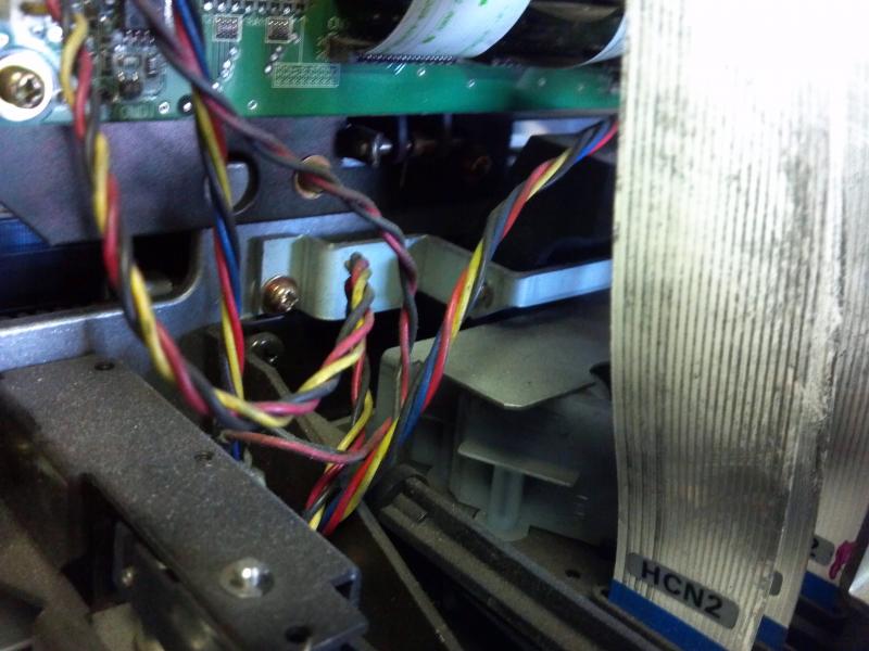

Richard G
I believe you have the wrong part I took some closeups of what mine looks like and the screws should match...
