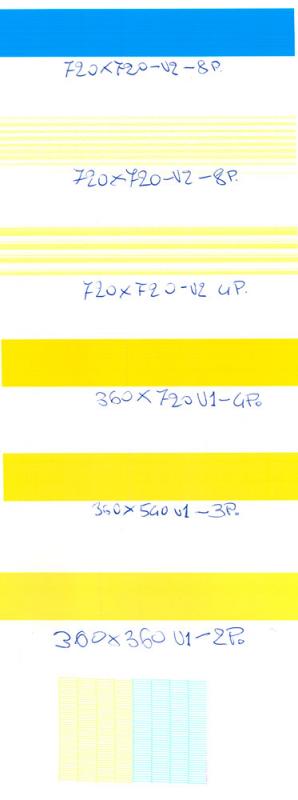

I have a JV3-160S for about 6 years, but I never see a thing happened.
After replacing the head of the cyan / yellow with a new one, and after have printed approximately 30 square meters, I started to have problems with missing yellow, and spray on the edges.
(while the cyan not be no problem). At this point I replaced the damper and the cable with a new one, but with no result.
I then decided to do the # TEST with various resolutions, and I found that up to 360x720 - 4 Steps printing is perfect, but when I go up to 720x720 (that is 4 to 8 steps) prints only alternate lines, whereas this does not happen on the cyan.
It could be a bad head? Why only 720x720 or more? :covereyes:
Thanks in advance for the help!
