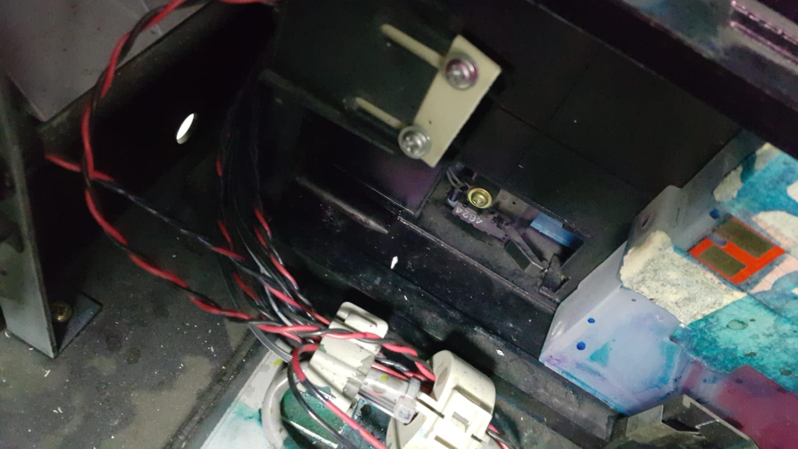

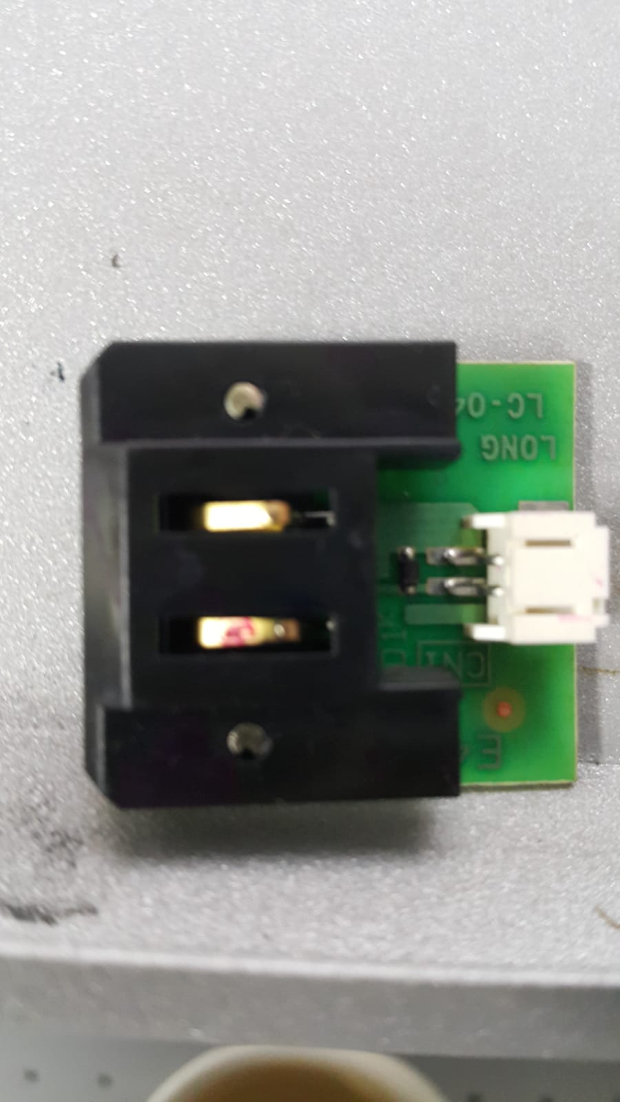

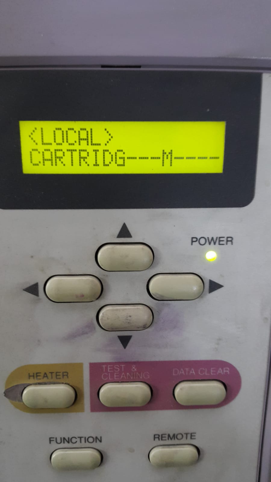

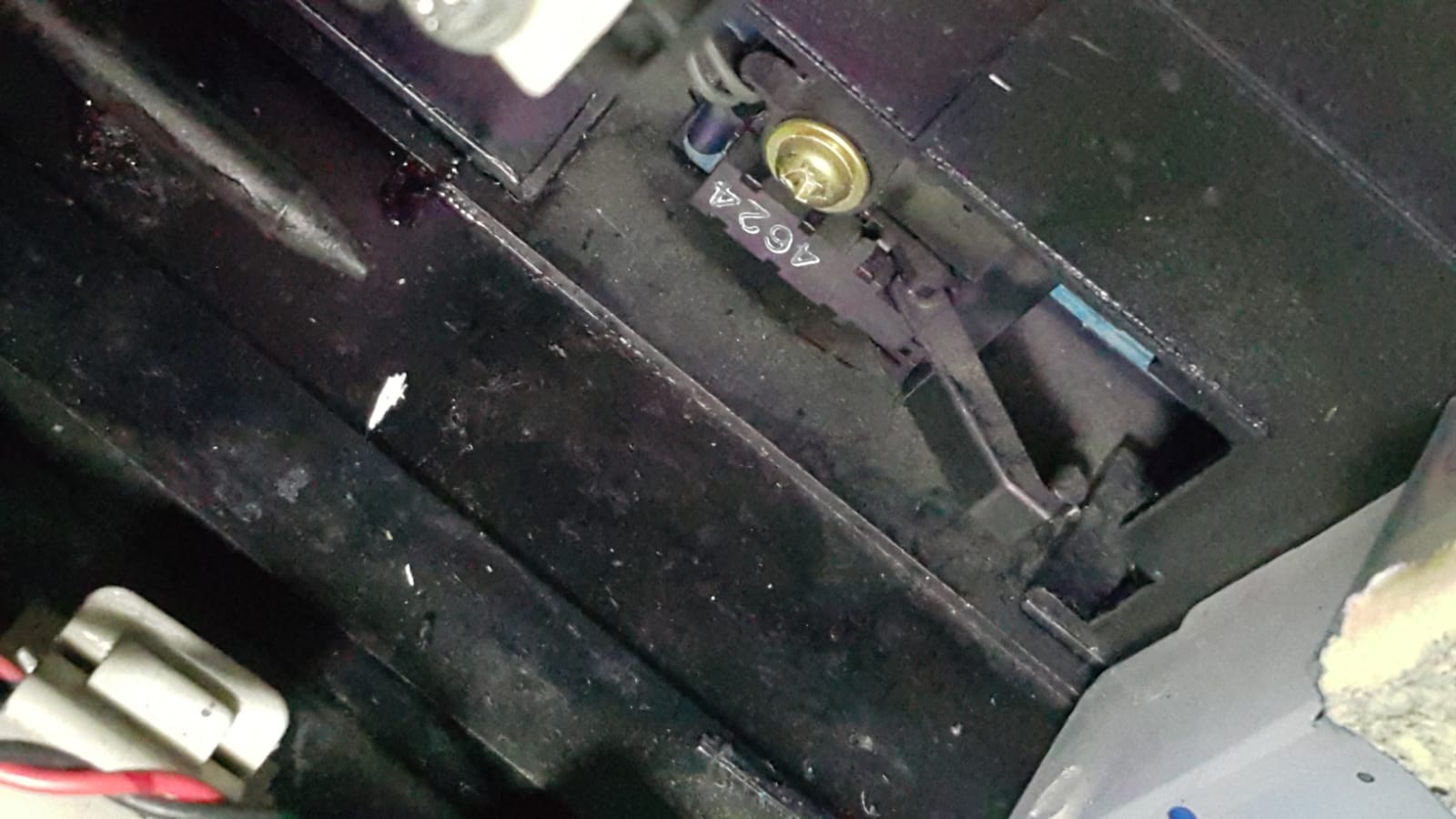

Same machine(Mimaki JV3 160 SP) - more or less - the same problem: on channel 4 (KKMM-CCYY) one of bouth Magenta chanel: one of Magenta cartrige it's no recognized!
By the way, when you said "your cartridge assembly switches that need rep..." - where are placed this cartrige assembly switches?
Many thanks!!! Have to chek this... if not have to change (ultimate solution!) the mother board.
