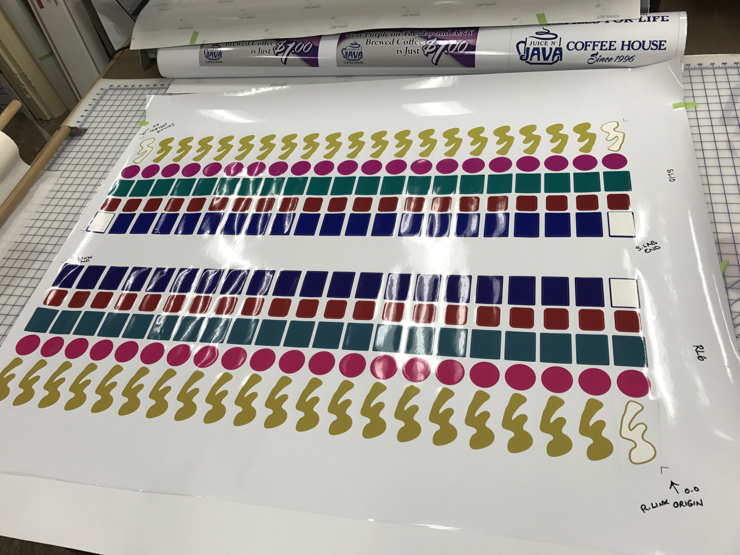

Hi DMF, I'm searching today for this same problem. I've had a Roland for over 10 years, I switched to the Mim CJV150, and it just can't cut right, despite finding all reg marks no problem. Multiple attempts with SL10 support, still no answer. Getting really frustrated, I've got a hell of a lot of SL files, but have had to output thru RasterLink instead.

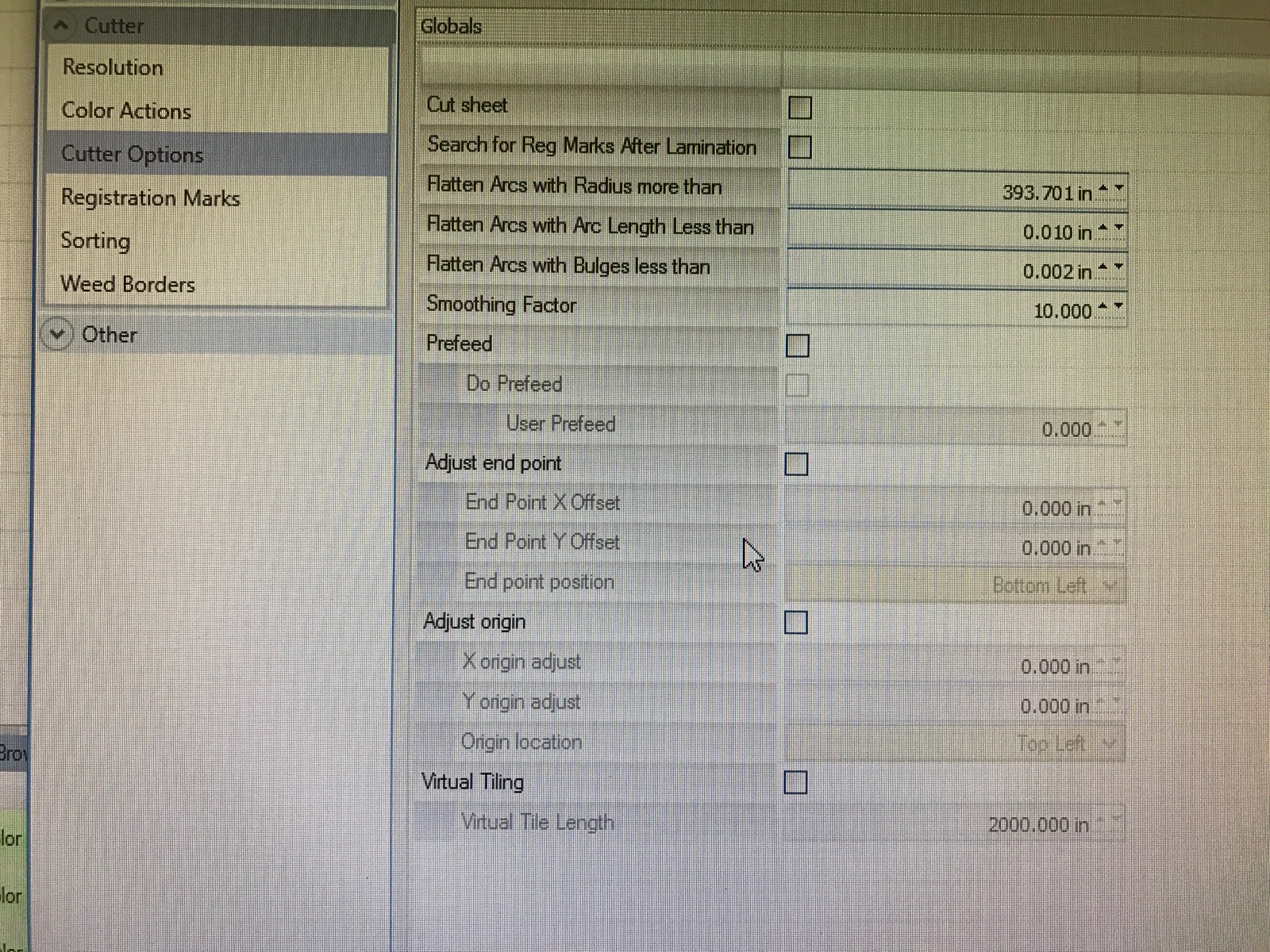

Oh brother, I hope you're right. Thank you so much, is this it? It isn't giving me an X and Y
