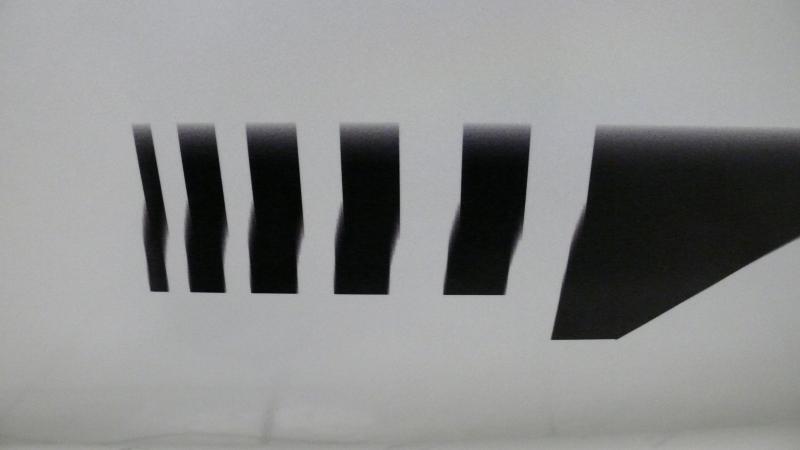

Ive attached a pic a what my jv33 is doing, its like moving or something then it gets back on track and then prints start off tracking, it will do it once in a while then its fine not sure.

encoder strip.....the clear strip that runs the length of the printer behind the head carriage.....you have dust, oil or ink on the encoder strip posibly.............clean it off with alcohol............

no still in the track, but it smeems like the strip is full of smudges of the cleaning, could that be it
u use alcohol???
don't use the cleaning solution for the printer......
the encoder strip doesn't like finger prints or anything foreign on it:
dust, ink, oil, etc................

you could take it out if you wanted to go through the work......make sure you remember how to put it back in and be careful not to bend/crease it and don't lose the spring on the far left side!

printing like earlier, printed about 2 feet, do I need to clean both sides of that strip or only the front facing side, I did only the front facing
Case
something could be on the other side as well......ink splatter, dust, oil, fingerprints, etc..........

yeah, it's harder to help without seeing it, but your first pic for sure indicates encoder issue.............i will try to help if i can...
