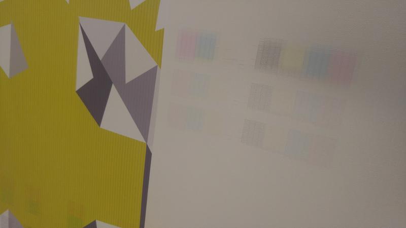

Our black ink from damper #5 is leaking into our yellow, damper #6. We have replaced both and ink is flowing through. We are concerned that the printer head is damaged. I have attached an image of the ink test.

Unfortunately I am leaning towards a damaged head. Have you flushed it recently? First check if there is ink in the black and yellow cartridges. I have run into this multiple times where the ink runs out but doesn't flag the machine. What happens is the pump runs and pulls on the empty cartridge and when the pump stops, the empty cartridge pulls ink from the cap back up into the other dampers near by. Judging by your test print and the fact that you have new dampers, I think the head is fried.

Definitely thinking the same thing about the printhead. We ran a clean and the yellow damper is actually pulling black into it from the printhead.
