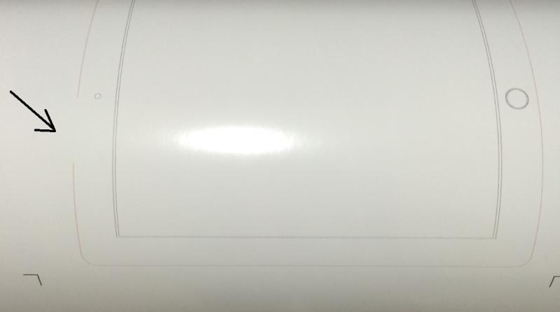

but only this print has a problem.
It about a same square line 0.1mm or less than 0.25mm.
In the picture you will see , I make circle , That it should print line , (Because it same line) (Because it square image same line).
I calling to seller 2 times with this problem.
1st staff come to my company and confuse with this , and after test more print and not fix , He try to print on his laptops , (and it have something change) , The hidden image change position.
(Hidden line on my Computer will hide same position) , (and his laptops change position of hidden line)
after more test , The 1st staff fixed this case by tell me to use Expand system in .AI and create out line before print for pass this before.
However I still confuse and serious for this problem why it hidden

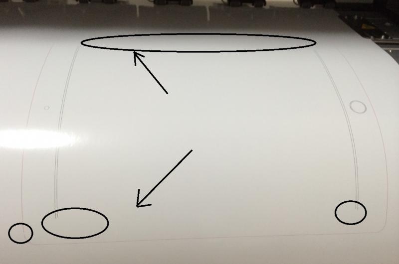

then
2nd staff come to my company and confuse with this case also , but this staff tell me to export to .Tiff and print.
then I need to know Why .AI cannot print normal with this square line my image. , and Why another laptops hidden position change.
or Is it problem from Windows or Rasterlink version ? (However I try to use Rasterlink from the BOX and Rasterlink latest version it still happen same problem)
