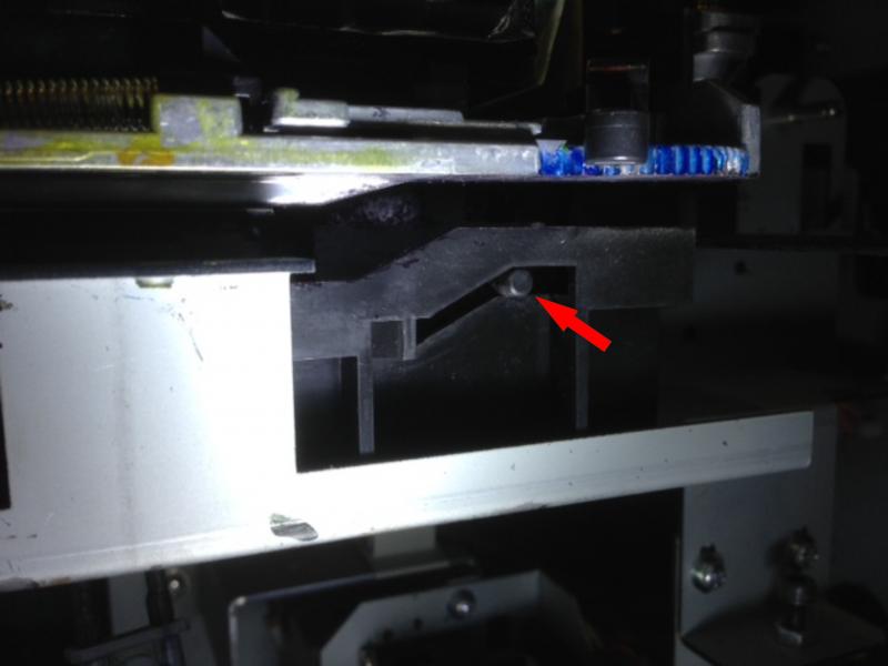

Sure sounds like a cap top issue... Stretch the spring that sits below the cap top to make sure it is applying a good upward pressure.
Check very closely for any flatspots on the cap top (As mentioned before I had a new one that was defective).
Make sure the alignment is good and that when the head seats on the cap top. The little cam is at the peak of the ramp (See attached pic).
Have you switched the dampers between the color that is failing and one that isn't? This is a quick way to rule out the ink train above the head.
