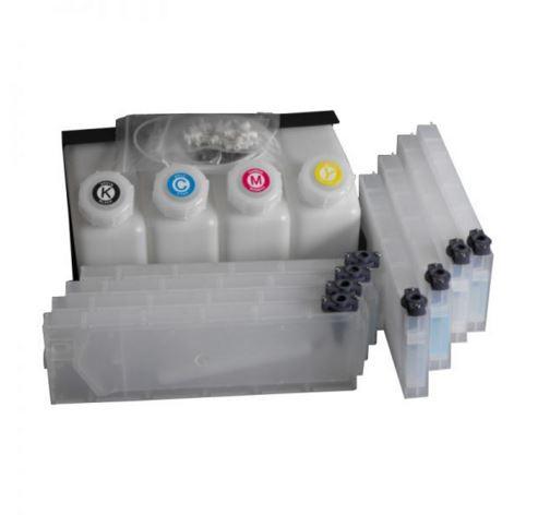

I worry because the inks im not so much worried about but more the quality of the sytem itself....here is a pic of the system they are trying to sell me on....it just seems to cheap to me IDK but i do appreciate the help

That one is kind of a middle ground type of system in my view. The floats work better than filling it yourself every time and allowing dust and particles to enter the system. I always have issues with these unless they have a bag in the cartridge. The Triangle one I installed for one of my customers didn't look like that. It had bags in the cartridges.

I very much agree with Vander on this. Even the middle ground setup like was pictured with the floats tend to be problematic. The (C)JV33 (as well as the newer (C)JV150/300) machines are extremely sensitive to pressures in the ink train. These machines have solenoid valves at the back of each cartridge slot and are much different than the ancient 4 head JV3 machines. Problem even with the float type setups is the pressures get screwy as the float goes up and down plus the fact that the inks are still in open tanks exposed to air, etc. Inks when made are degassed and when in a sealed ink bag setup like regular cartridges or ink bag bulk setups the ink is never exposed to air.
