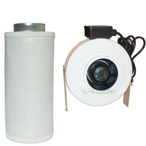

So, any suggestions on venting, to save a little money? hehehe.

Anyone that has any info on venting one please share, I need to do it with mine. Thanks in advance!

I used a 6" inline duct fan liek the one linked above for ours but no carbon filter. I ran 4" flex pipe from the printer to a 6" hard pipe by the ceiling which goes to the inline fan then back down to a 4" dryer exhaust vent I installed in the outside wall. Just ran a wall switch to cut the fan off and on and just run that when we are printing a lot.
