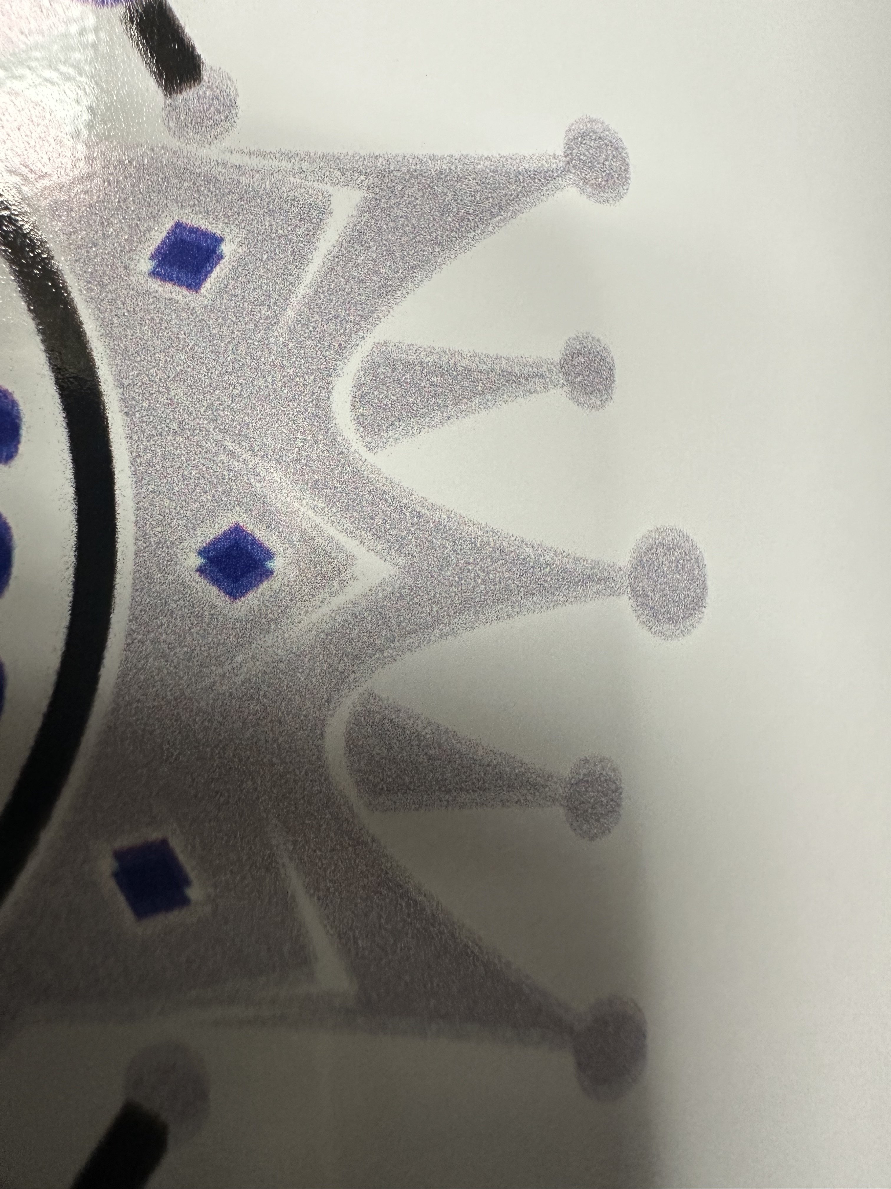

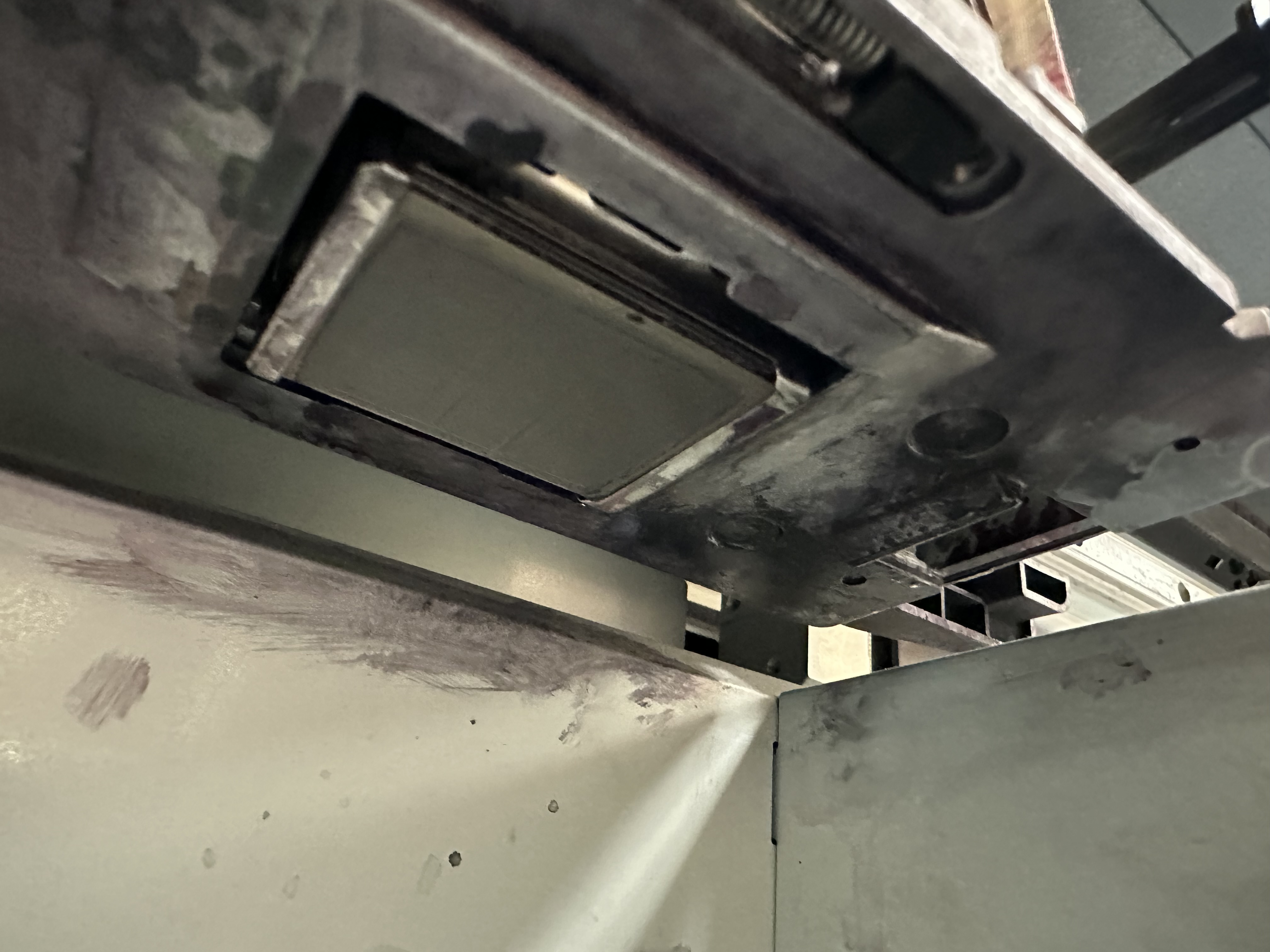

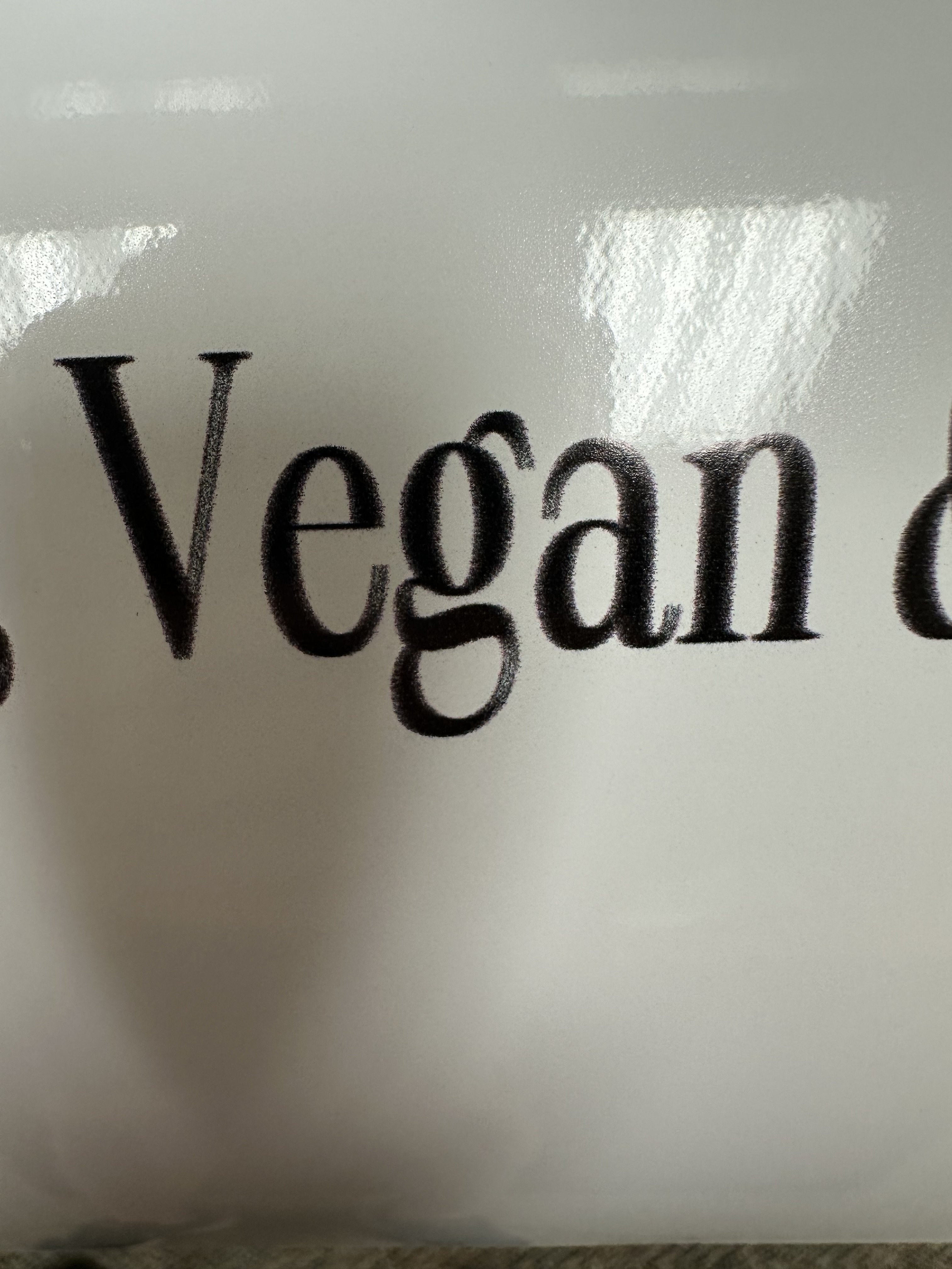

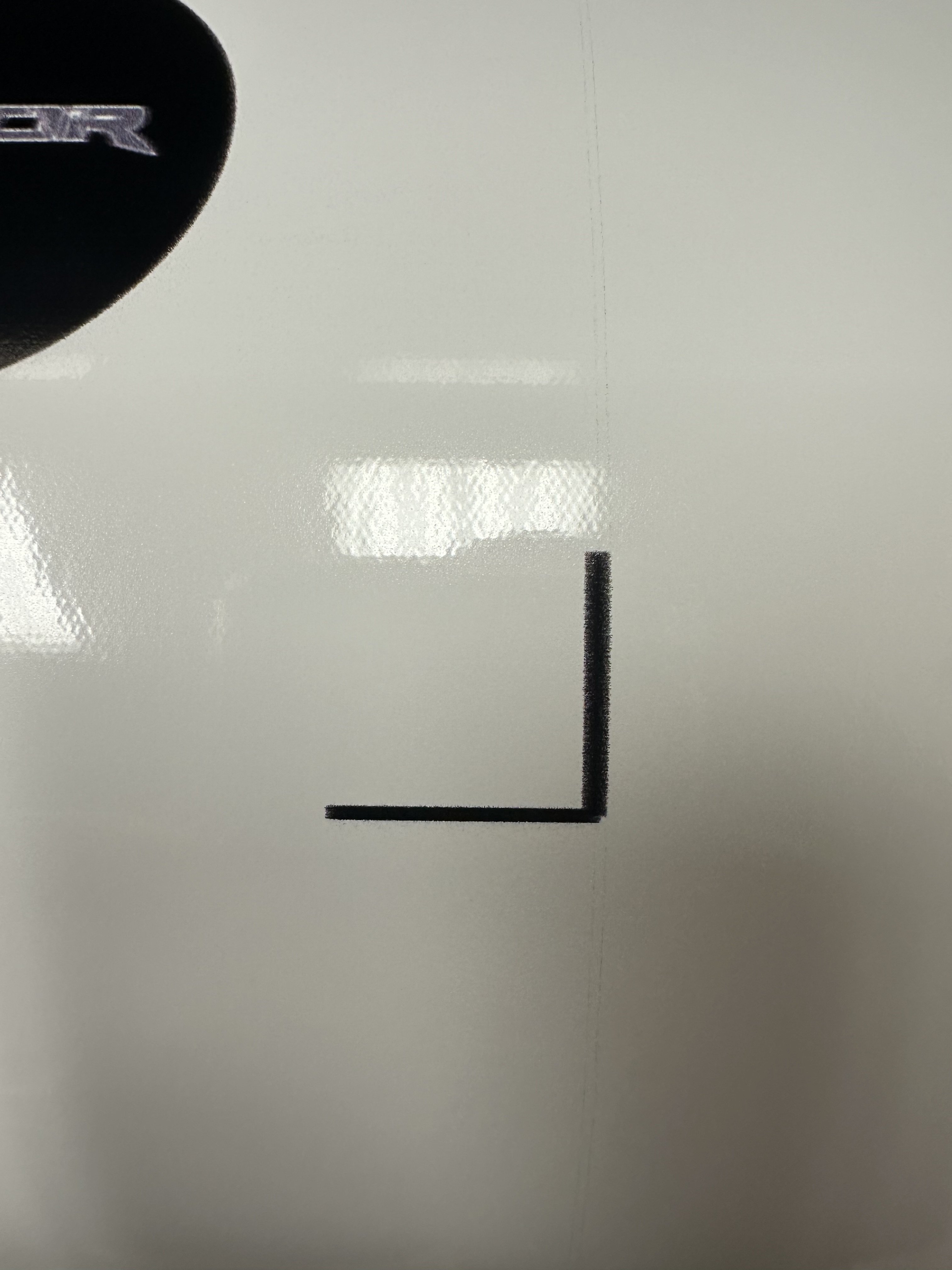

Recently i have run into an issue where my jv33 starts printing blurry on straight line edges. Below please see images of the print quality and the head. Do you think I need a new head? Is it normal for a head to look like this? Any advice will be great. I have tried all alignments but it seems that it’s not getting better. If I print in slow bi directional it still has a blurry effect

Also would anyone know why when printing the printer tries to print a very feint line in the right side. You can see it in some of the photos. The head will go back and forth on a spot where there is no print even needed.

That head looks like it's seen better days, and is very dirty... Start with a soak and a good proper cleaning, might help.

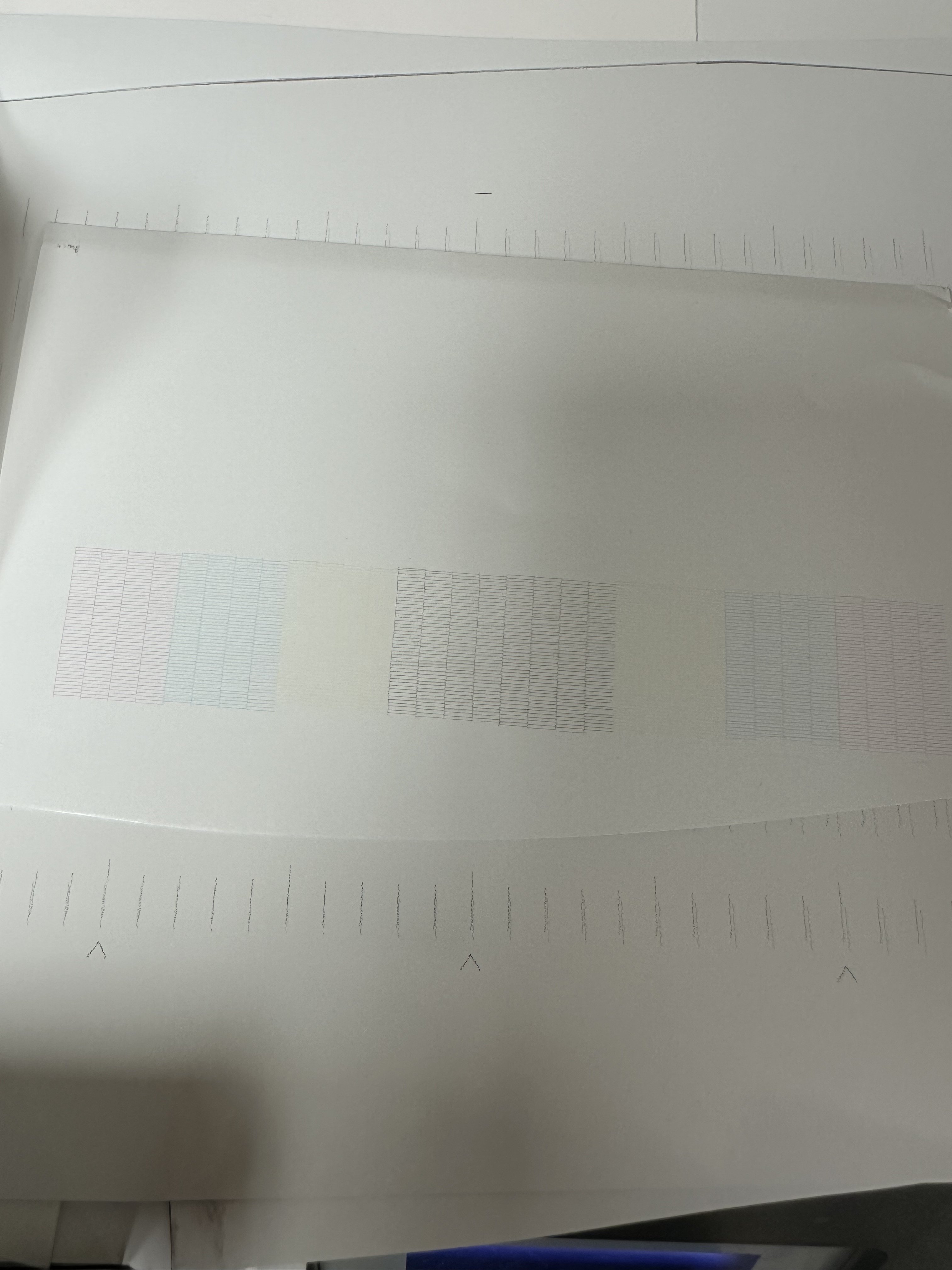

What do the test prints look like, that tells us more than these, post some pics of those.
If it's printing lines on the edge, you may have the color strip turned on, it'll print 4 color lines down the edge. That's set in the rip software. It could also mean an electronics issue.

Thanks for the reply. Here is a test print

I think the test print looks okay.
The cap isn't lining up to the underside of the head well. Strangely, it's out in the north south direction, not east/west (Y axis).
AFAIK there's no adjustment for that. But I would look to see why. Maybe the whole capping station is out of position?
I presume the head is seated properly.
As for the fuzzy print - have you looked at and cleaned the encoder strip?
I see you have tried the drop position adjustment.
Is it out much? There is a more major adjustment available in the service menu

Thank you for the reply. I have tried to wipe off the encoder strip but nothing changed. I do have a little ink on it by the capping station, do you think that would throw the whole thing off?
I have tried the service adjust and still nothing.
Are you sure it’s the head is off in the feed direction? The ghosting of lines only shows on the edge of colors changing on the print, it does not show in the middle of a solid color

Just to narrow things down a bit, have you tried printing blocks of each color (CMYK) and having it set to just print pure for each and seeing if one color has it opposed to all. I don't know if you can on Mimaki like you can on Roland, but can you print a service mode test print with the more precise smaller bar to see if there is some other defects. Although the head doesn't appear to have any significant damage, if it's old enough it could be just be starting to go, but that regular nozzle test print looks fine, so I might be lead to believe there is something else at play, almost looks like a static issue. Have you tried other medias and do they look any differently then this?

Thank you for the reply, I have tried to test print blocks of pure coloured ink and it still gives the same ghosting on the sides of each block. I have not seen a feature to do a whole test print like you mentioned for Mimaki. I have used other media’s before and they were doing the same thing. Some how I fixed it back a year ago but i swear it was from a drop pos adjustment. Now nothing seems to change. I have recently bought a humidifier because my office space is a little dry but I didn’t see any difference. This media was printing good a couple weeks ago, this issue has only happened after I did a drop pos adjustment. Not it seems like every time I do one the values change and the print quality after does not get better.

Understood. I haven't used a Mimaki, so wasn't sure if it had that other nozzle test in the service menu like it does on my Roland's. How old is that head and do you know how many hits it has on it. Maybe it is end of life, but from that nozzle test, it looks pretty good, so it's hard to believe it's that.

I unfortunately do not know the head age, It may be original, I bought the printer off a guy who was retiring and closing his business. I have suspicion that it could be the black part of the head going because ever since I got it the black never seem to print perfect or near perfect. Small fonts and prints would come blurry in black. I was fine with this because I do mostly large prints but this double line ghosting is new and I would be content just to solve this issue. I have been told to replace the encoder strip. But like it’s everywhere on the media this is happening, does the encoder strip cause issues throughout if say the starting portion is damaged?
