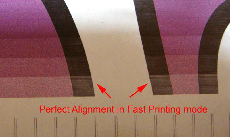

I've removed the JV33 head on 2 machines out today for a major ink dust cleaning... (the dust is building up fast on print head cable) ... then I clean them all and put them back.
Then I got into "Head Slant Adjustment", and "Drop Position Adjustment"...
in "Fast scanning mode" ... in all Draft/Draft2/Fine/Fine2...

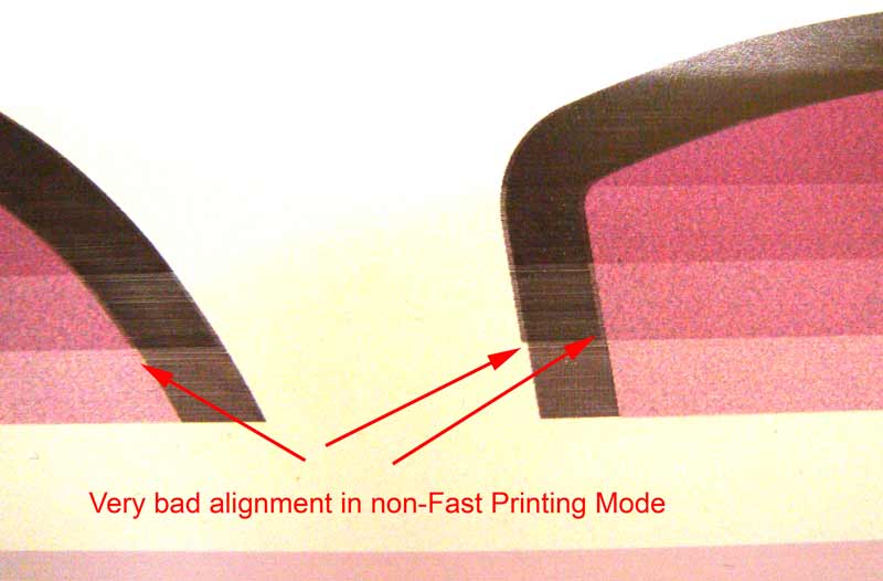

Everything seems to look fine at first, ... so I started printing some jobs... and I am quite shocked to see that .... while I can print perfectly fine in "fast print mode", .... the alignment became really bad in "non-fast printing mode".
So, I tried another "Drop Position Adjustment" in "non-fast printing mode"... and got the situation reversed ... now perfect in "standard speed",.. then seriously out of alignment in "fast printing mode" instead !!
The symptom is just the same on both printer !! and quite different on the third machine which is untouched ... and can print perfectly well on both speed.
Would anyone please kindly tell me what I am doing wrong ? I am suspecting I may miss something like coarse alignment or print head placement before/after screwing it back on ? Is there something I should look for ?
Thank you ahead for any help or suggestions .... :notworthy:

Well from our experience, once you remove a head and put it back, there is about a 2-3 hour alignment procedure that has to be done to get everything perfect again. This is according to techs we know but you may want to talk to a couple online Mimaki experts.
Alwayon
Thank you very much, DoubleDown. Fortunately, the case has been solved yesterday.
It turns out that the "Drop Position Adjustment" in service mode is meant to only be in first stage. After that ... the next thing to do is to do another "Drop Position Adjustment" in Maintenance menu (with 8 patterns) .... then everything will be perfect.
