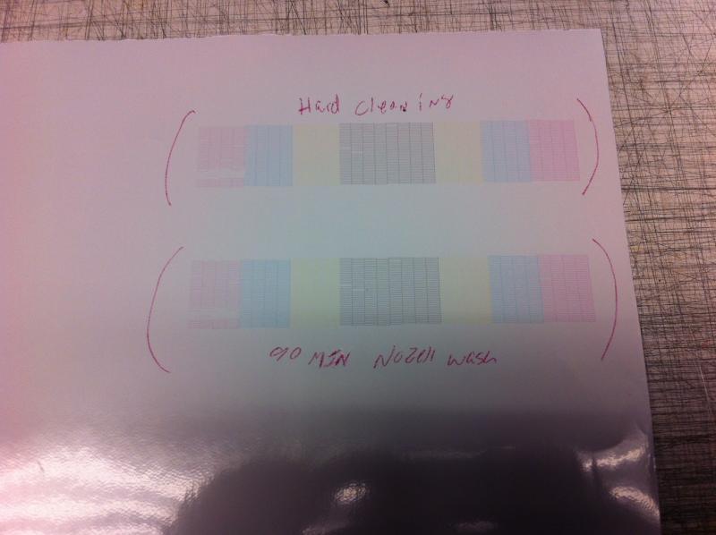

Hey guys I got a jv33 its about 6 years old, Running a 3rd party ink. I have been fighting with it all week we had a Thunder storm move through 2 days last week and I left the printer unplugged. I had a friend who had lightning run in on his printer so I wanted to be safe. When we turned the printer on we had a few nozzles out on one of the m sides. I have cleaned and cleaned and done nozzle washes I had one test draw yesterday with 100% nozzles but after printing for about 15 min I was back to square one. Anyone have any advice to speed things up or how to fix this.

Get a big UPS for you printer first of all. Like 2000va or larger. Those will have a few benefits, most stabilize output power which is good, most all are also top of the line surge suppressors, and of course the added benefit of continuous priting even during power flickers of any sort (as long as the RIP is also on a UPS). We have a commercial grade Liebert 6000va just for our printer, cutter, and RIP PC. You never want to leave you machine unplugged for more than a few hours if possible. The "parked" position for the head over the capping station is also held under very light motor tension, when power is lost it slacks off the cap a little.
Getting your nozzles back, probably another 90 min soak and a little bit of printing will probably get them back.

:banghead: Got all but a few nozzles back this morning printed about an hour did a test draw between each print and all looked good. Printed a 20ft sign 4ft wide and was looking good until about the last 3ft. Did a test draw when It finnished and the same few rows were out again.

This has happened to me a few times very stressful as you hope the head is not bad most times not.
What I would do is do a nozzle soak let it soak an hour and then do a hard clean if its not back do any ink fill its like a hard clean but first it puts suction on the head for a few seconds and then it opens the ink valves and it sucks ink a little longer than a hard clean you may have to run a few cleans and maybe a few ink fills to get it back and stay back.
