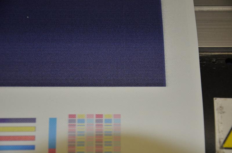

Fearing the worst, I just tried it out again today and it seems that I have lost most (80%) of the black. Test draw overall looks pretty bad.
It was printing OK before I was sick, except for:
- minor banding on cyan
- some intermittent & temporary bleeding of black into yellow (mostly at very start of a print job for some odd reason)
Test draw was about 95% ok
Anyway, here's a photo of a solid black print attempt...
The "Black" looks more like a dark blue or purple. Also notice the bleed at the square edge - that's the same fuzzy bleed I see on yellow sometimes.

Are you absolutely certain that the cartridge valves are actually open? You certainly should have gotten better results after pulling on the Capping Station but the result you describe sort of sounds like what I'd expect if the valves are closed - i.e. the syringing created negative pressure in the head and when you removed the syringe the ink retracted back up into the Head, sucking air and waste ink back up into the Head and Dampers.
To check if the valves are open and working properly, here is what I would suggest:
1. Remove Damper from Print Head (leave ink line attached though)
2. Invert the Damper
3. Gently press the "button" on the side of the Damper
4. If valves are open and ink is flowing then it should up out of the inverted end of the damper - This is also a goo way to purge air out of the damper. Be ready with a lint free cloth to catch ink that comes out and don't spill it on any electronics.
