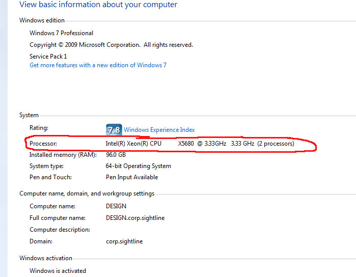

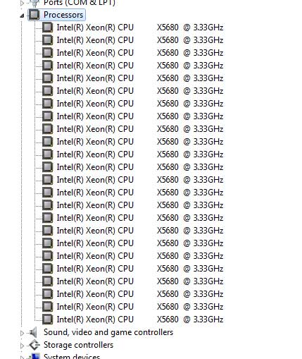

Back on the computer - try this on Production Manager. Under the top Edit menu, go to Preferences. Make sure "Print while ripping" is unchecked. If that is checked and the computer is ripping a file in multiple chunks then it might be busy ripping parts of the file while its also trying to print parts of it which can slow it down to the point that printing will pause while its starving for data to get to it fast enough. Depending on the processor in the computer you also might want to set the maximum number of RIP threads to be one less than what the computer has. Ours has a quad core Intel. I have it set to 3 on ours. I figure this maximizes the ability of the machine to RIP files while still leaving one processor core free for Windows to use for the operating system itself. If you have a dual core processor you might try setting it to 1. Do not count hyper threading cores as additional cores though. If you are unsure look at the computer properties and let me know what it says the processor is and I can tell you for sure. Attached shows where it says the specific processor (this is on my design workstation, way overkill for the rip). The first screen will also show how much ram you have and if you are running 32 or 64 bit Windows. If I look in Windows Device Manager mine shows 24 processors but realistically it is only 12 - the Xeon processors in this design workstation have hypertreading. Make sure on the main Production Manager window that the hard drive(s) shown at the bottom all have plenty of free space. The hard drive(s) settings for Production Manager are also in the preferences menu. If you have more than one drive I suggest having Flexi installed on C: as normal but setting the Archive, Jobs, and Temporary files pointed to a folder on another drive. Also the actual hard drive itself could be the culprit if it is a slow hard drive. If the hard drive is just too slow then it will not be able to move the data to the printer fast enough. If that is the case though then the printer would just pause while printing while it waits for more data but would start printing again on its own and you might have to look into upgrading the hard driver to a faster one. You also should occasionally clear out some of the old files in Production Manager (if you have them default to hold in the list). I delete old jobs out of ours about every two weeks or so keeping only the last 2 to 4 weeks of jobs in there. Also there is the "Clear Job Log" under the View menu in Production Manager which is also probably good to do once in a while but that log can also help in troubleshooting things. Also - what specific version of Flexisign?
