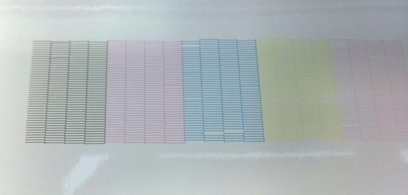

So finally got around to loading this up with ink, So far I have dampers and caps in it. Had heads soaking this whole time and figured I should give it a whirl.
I think fairly well for the price I paid. Now to get some profiling up and going and see what it can do.
