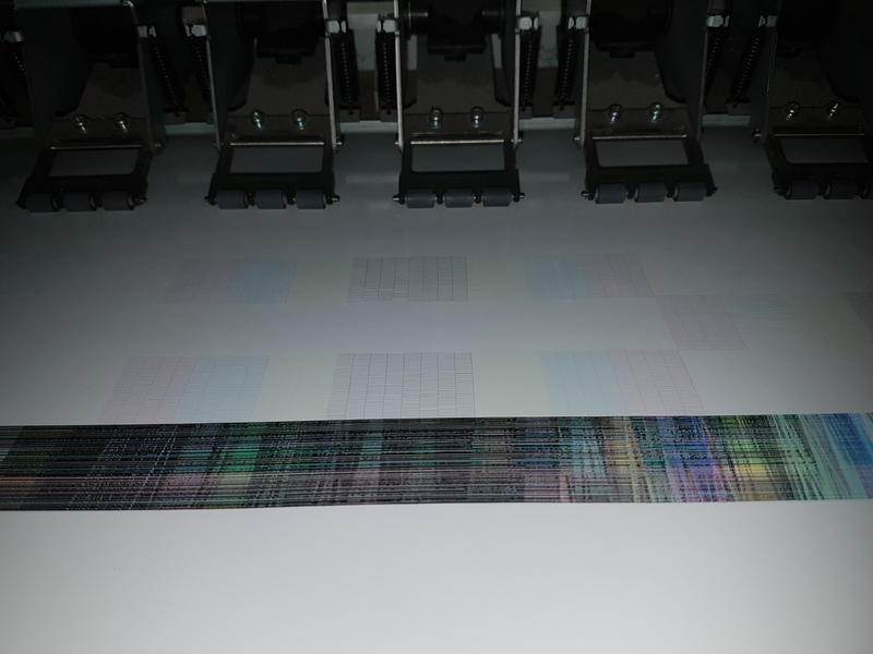

I have been having issue with my Jv55 past 2 days with missing cyan on head 2 and 4. Just today I have been getting ink striks on head 4.
attachment.php
Please see image. would any one be able to advice me what is happening?
inkjet frank
