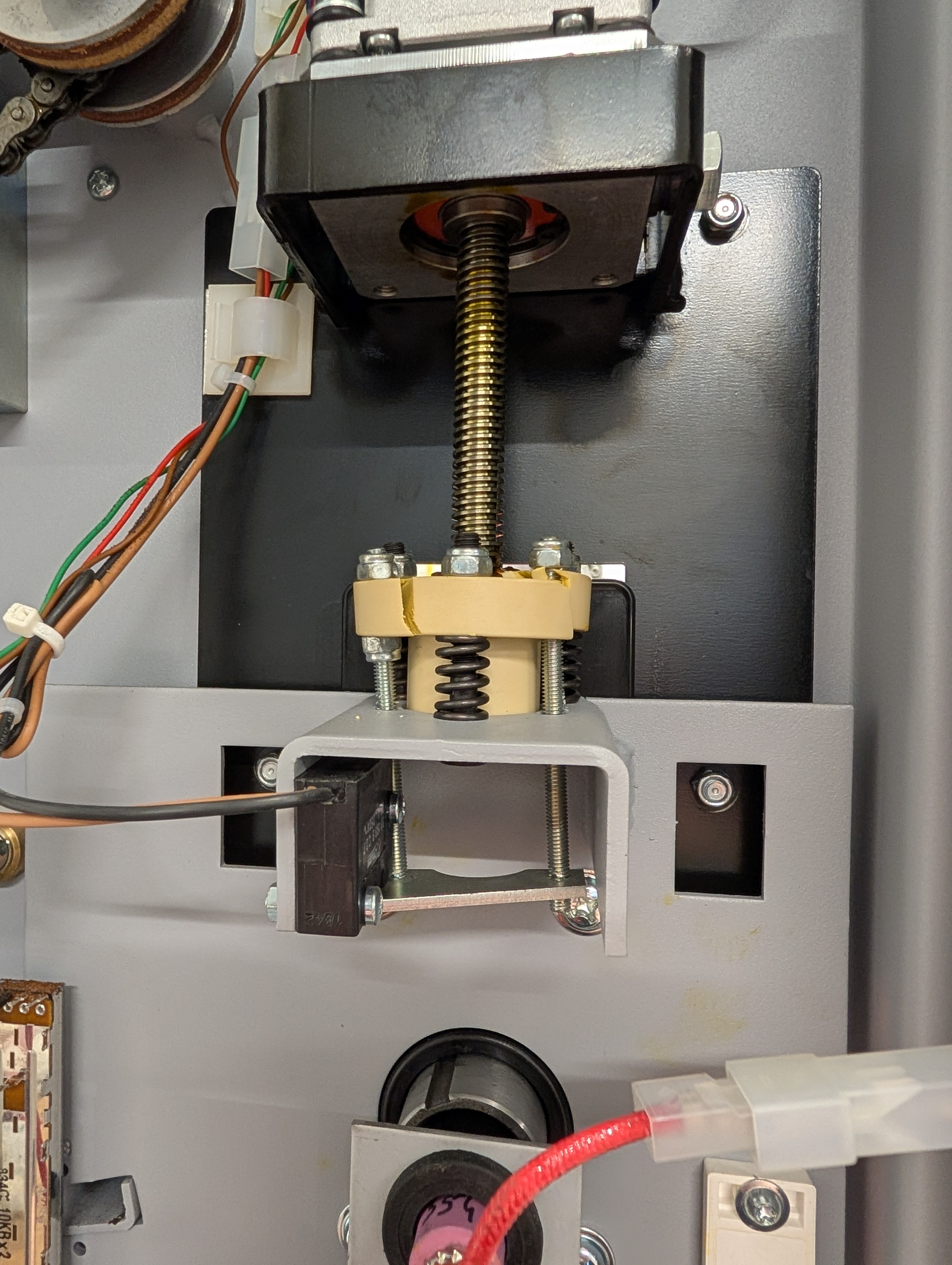

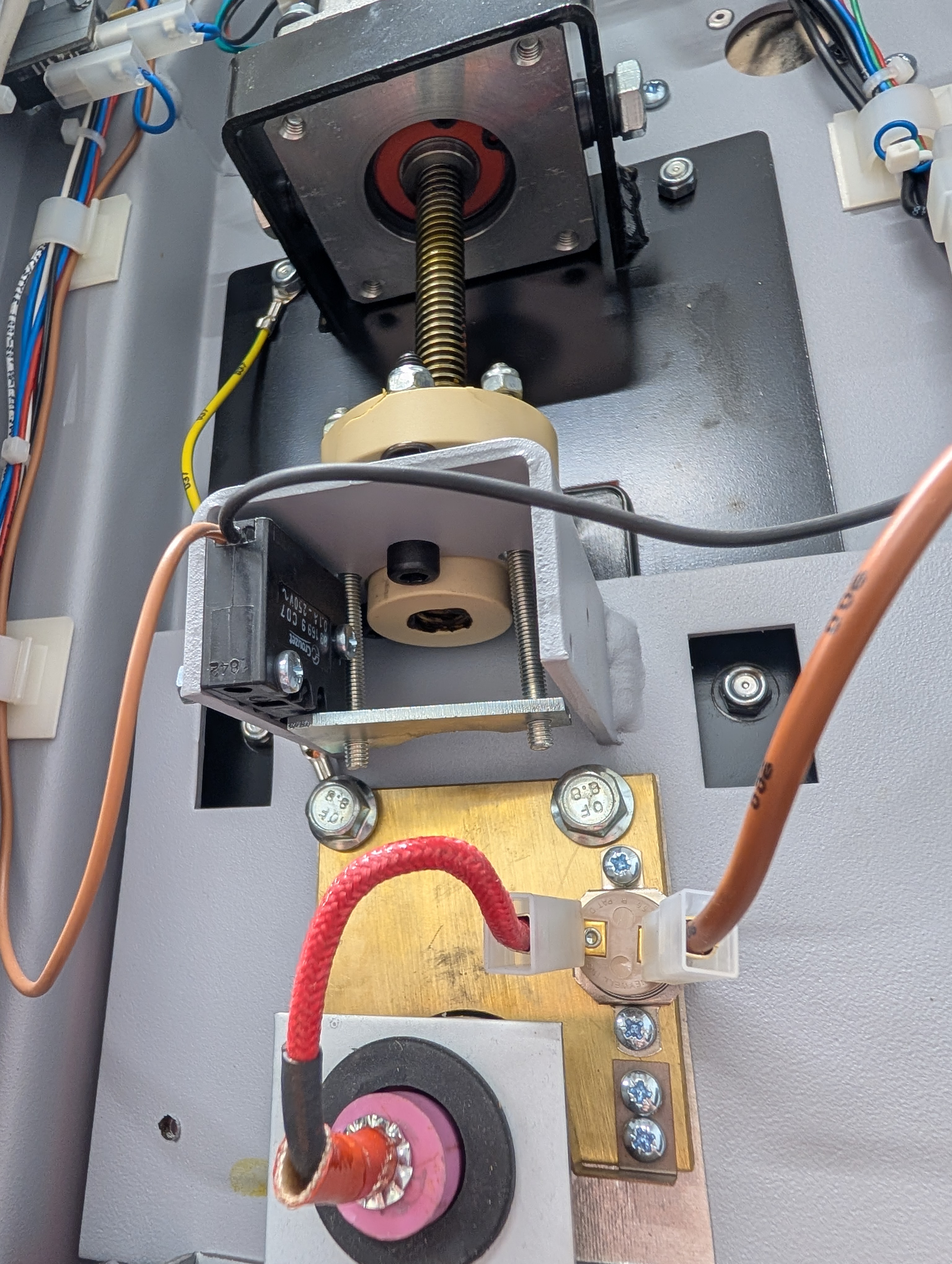

Don't be like me. I must have turned on auto and walked away on a Friday, came in the following Monday to the alarm blaring and about 30' of film rolled back onto the rollers before it busted both the trapezoidal nuts on the stepper motor shafts. I got new nuts in ($98 each, not as bad as I was expecting) but they didn't come with any sort of instructions or if it auto-calibrates whether the roller is level or not (I think it does?), so I was hoping someone could pop the side panel off their machine and take some pictures of how it should look. I need photos with the roller down and up so I can see when the sensor is engaged/disengaged.

Think I got it working, so no need for pictures. Didn't have time to run something through it, but rollers are level and everything seems to work.
