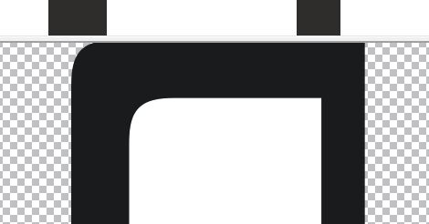

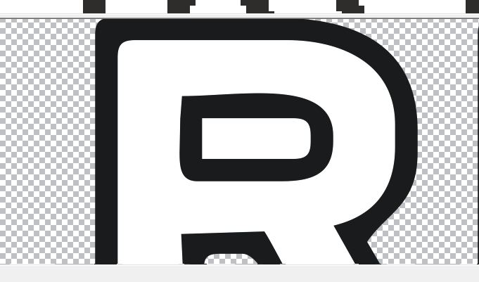

I am relatively new to Vinyl work and am working on a small personal project. My company logo needs to be cut out so I can put it on my shop door and car. My question is how do I keep line clarity in my logo. Whats happening when I am converting the logo from a JPEG to an editable image in Coreldraw X4, in the process I am loosing some of the Straightness and clarity of my lines. Its not noticeable at a quick glance but to me looking closely I can see it. Its mainly in the curves of the letters C and E and such. I tried adjusting the Mode and trace settings but even still when I use the outline pen it is still there.
I have attached a couple images for reference.
Any suggestions?
Thank you in advance.
Xll_LUKE_llX
In the original JPEG the image is perfect all the lines are clear and straight. I just cant get it to maintain that clarity.
