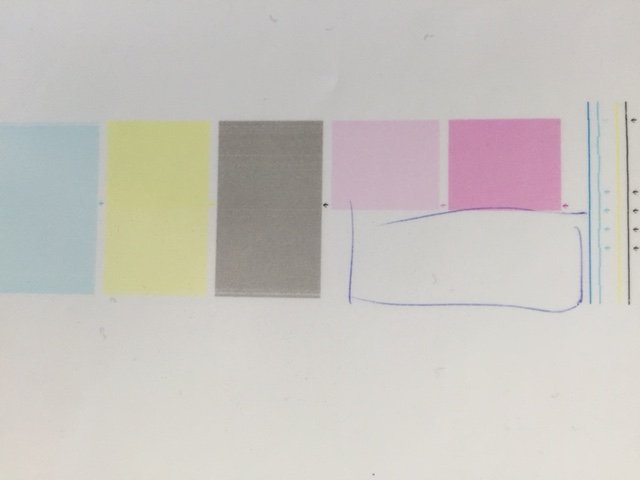

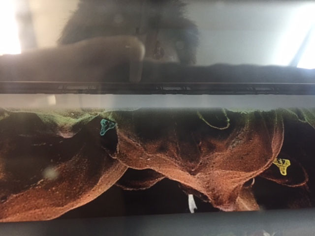

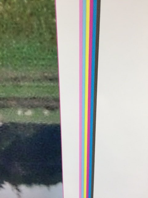

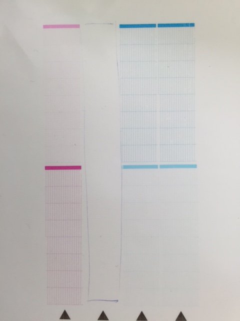

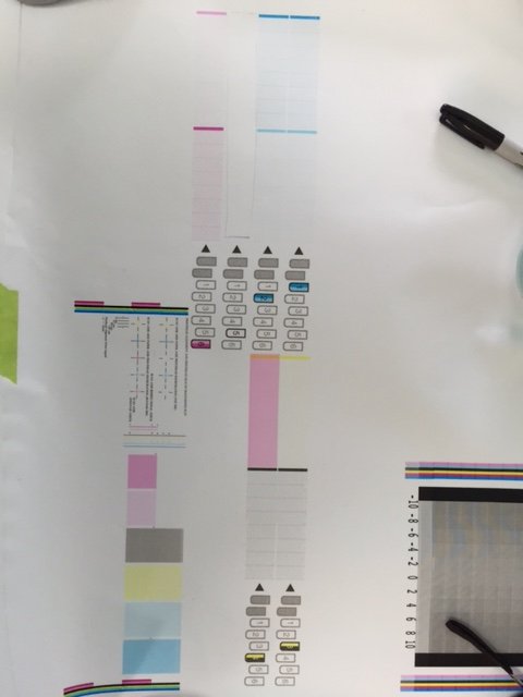

Something weird happen after I had a head strike, got a error code 98:03 which asked me to print a "head status plot" which I did and followed up with several print head cleans, but I noticed half the magenta is missing and won't come back. Its also now printing a weird pass of green before printing colour over the top which makes everything look fine, but it seems weird. The CMYK test shows no problem.
Any ideas?

Head number 5 (M-lm) is not firing on the nozzle test print. You can remove and reinstall that head and see if it will come back. If it does not you will want to replace that printhead.
NormanL
Thats a great idea, the head strike must of moved the print head, will give it ago once it stops printing, tyvm for the suggestion
