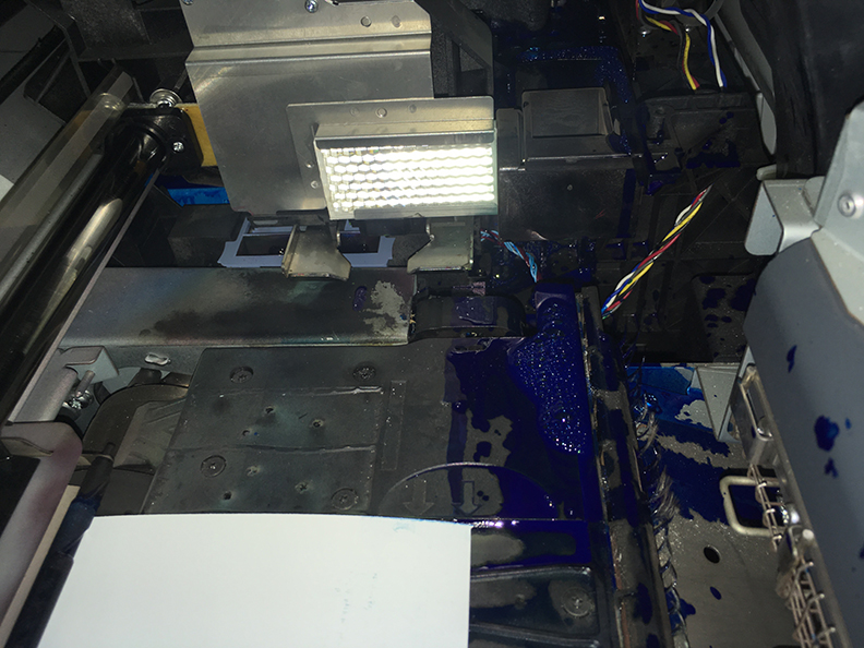

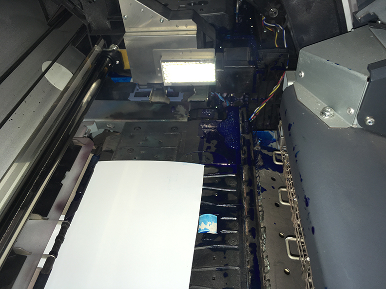

I really have no idea if this is death, or merely a flesh wound, so here I am with the events, & some pics...
I put in a new C/LC Printhead...
The alignment page was pristine, but it tried to do an auto-cut, & my blade is dull so I never use that.

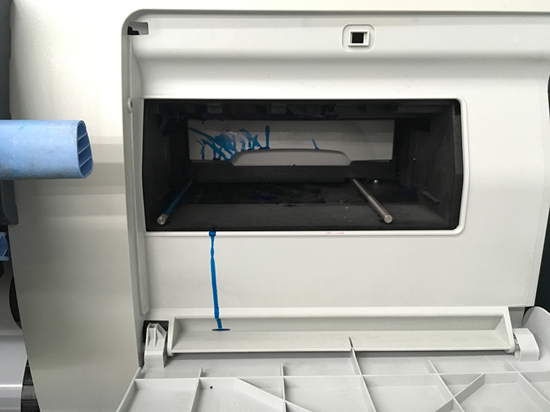

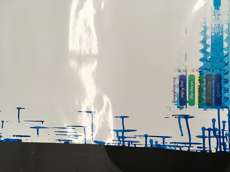

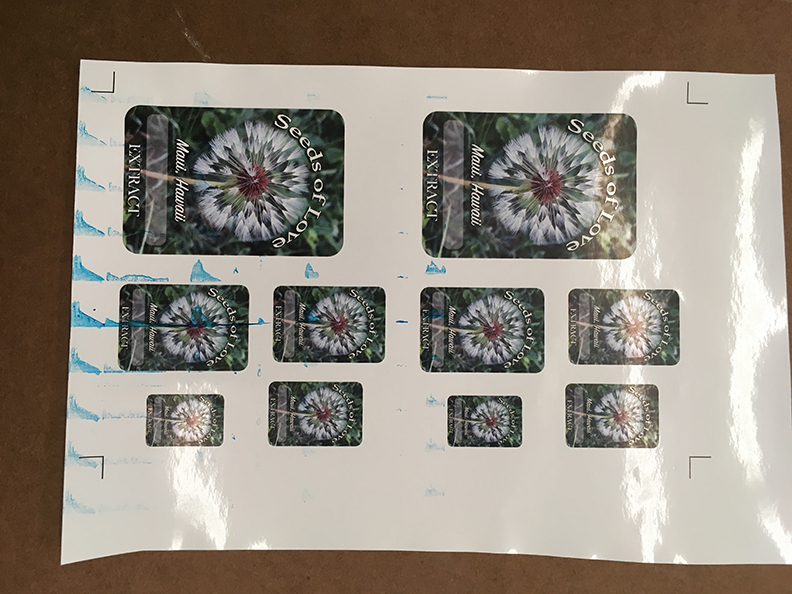

Since it didn't cut all the way through, I didn't even notice it was cut at all, and when I started to send a print, I got a head strike. It seemed like one of the more subtle or minor strikes of the dozens over ten years... but the next 1 sq. foot test had a few cyan smudges on it, which seemed to be phasing out at the end of the 1 foot.
Well, then I tried a larger print, walked away for a couple minutes, and the cyan was getting everywhere!!
The other part of this whole challenge is that I am on a plane tomorrow night & will be gone for a month.
I was mostly caught up & I have people around here to help print a few things before i go, but I just wonder what to do about this mess?
I have no idea if this is easy to clean, or if it's so hard it's not worth doing.
Anybody had this issue?
Know what to do?

Doug - we still keep a 25500 on reserve and had the same exact issue a year or two ago. It turned out to be the ink lines that split from the assembly (no idea how it happened). A tech was able to fix it within a day for under $1000. It was suggested to me to shut everything down, clean whatever ink you can see (you'll be away a month - better to not let it sit until you return), then let the tech take care of it. Hopefully problem solved!
Kevyar
I had this happen on our HP26500. HP tech came out and replaced parts I think the total cost was $1900. Runs fine now.
