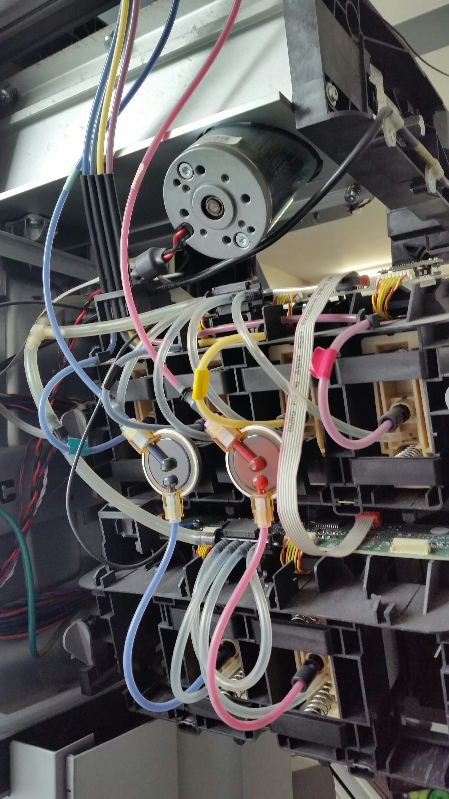

I apologize for it taking awhile to get back here. I took the side cover off and everything looks good. I don't see bubbles in the ink lines or any spilled ink. I attached a photo.

Have you tried swapping the magenta printheads? Does the problem follow the printhead or does it stay in the same spot? If it follows the prinhead then you are still having printhead issues. If it stays in the same printhead slot then you know you have an issue with the printhead.
Also there are service menu tests to test the ink delivery on that machine. If you do have the service manual go to the page on IDS Ink Deliver System. Scroll down and it will give you a few tests that you can do to figure out what's happening.

Swapping the print heads fixed our problem, but one other person said to follow the ink lines from the head to the pumps behind the ink take and look for splatter of magenta ink. It could be a ruptured ink line too. I hope this helps.
