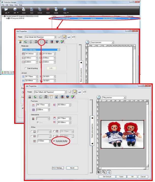

I will personally not recommend to turn off the OMAS. The OMAS media advance lecture is much more reliable than the one done by the encoder.
When printing determinate medias, dimensional variations from tile to tile can appear, in theses cases I will recommend you to invert the alternative tiles, which has the effect of placing the right side of the first plot next to the right side of the second plot and the left side of the second plot next to the left side of the third, so all contiguous areas belong to the same side of the roll and, hence, have the same length. This is a feature that all RIPs have available.
For your specific case, using Flexi, here I'll attach you an image on how to turn on this feature:
