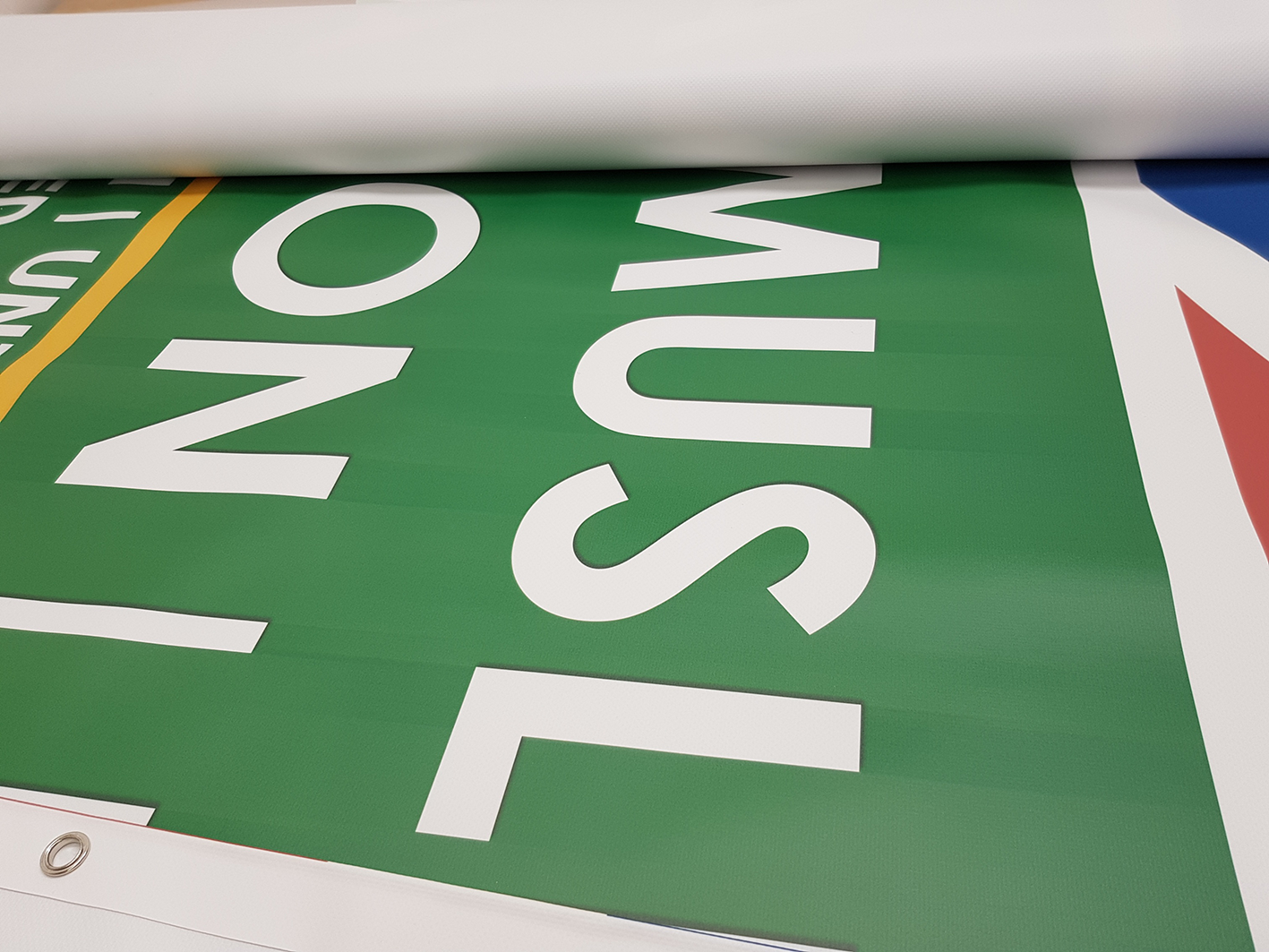

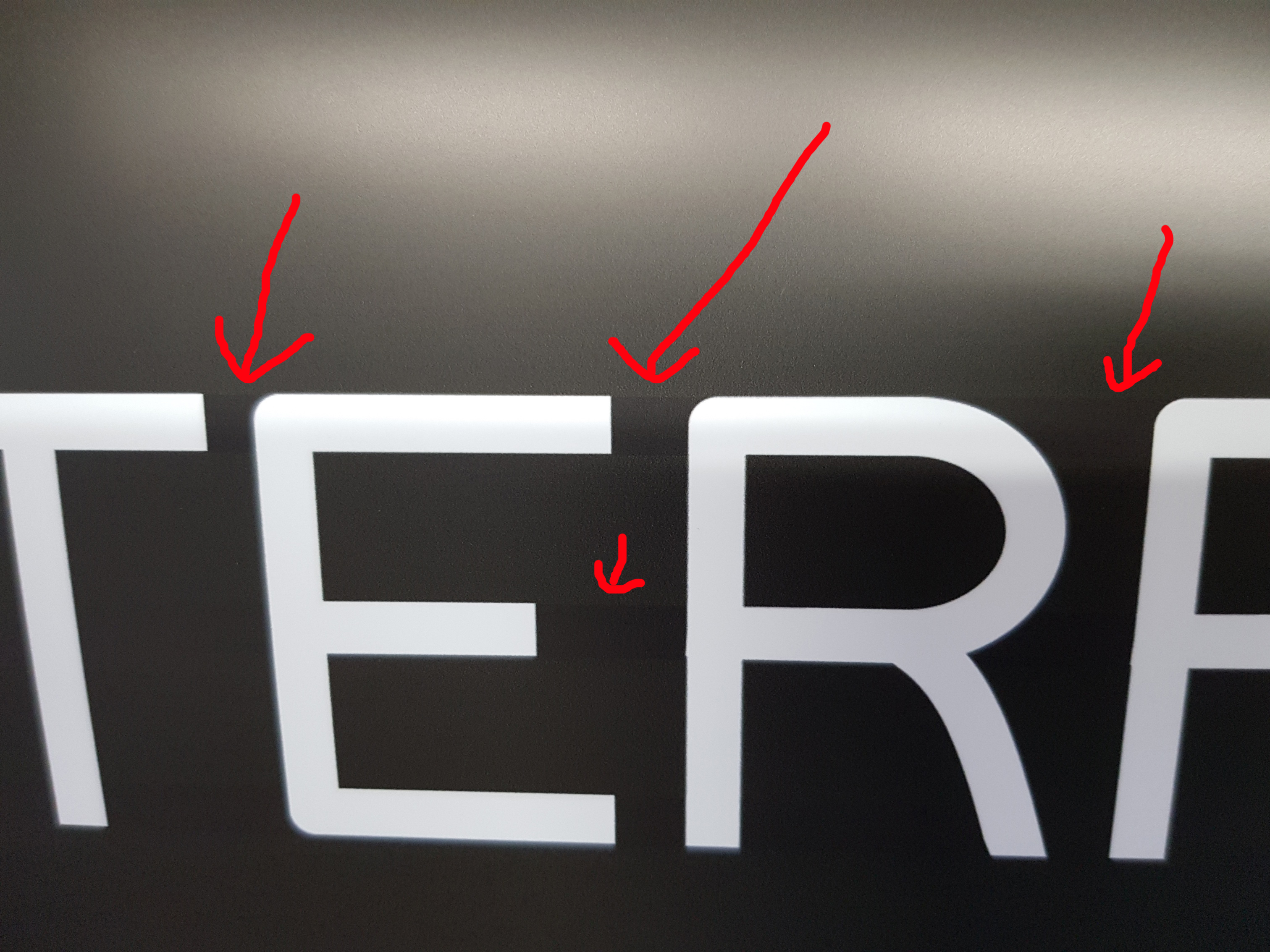

Im getting Horizontal Colour variation on mostly darker areas in print. printing on all stocks, paper, vinyl, scrim, roll up lightbloc.
Tried colour variation setting on printer menu, HP Colour configration on RIP (Wasatch Soft Rip), printhead cleaning.
Problem seems to be intermittent. but more often than not.
Its not Banding.
Please see the images

Odd how it seems to be coming off the ends of your letters. What file type are you printing from? Maybe save one as a different file type and see if it still does the same thing.

It's where is less background colour and more white on that pass, letters like U,L,N or when the top of the letters are in the same line, like TER.
