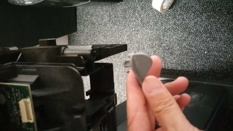

Haven't had an issue with the printer 'till today. It's showing Light Magenta and Light Cyan cartridges as missing, I've reseated them, replaced with a new one, rebooted, power cycle, erase the EEPROM still no luck.
Anyone run across this?
**edit**
We've used HP cartridges from day one.
buffalocanvas
Found the issue
the lower ink station is on a slider and there are two grey clips that keep it forward, the right clip was snapped off. I have it working temporarily but I don't think this is a part that has a replacement :(

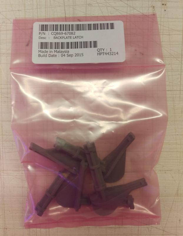

Happened to me too, they sell replacements but I'm currently trusting my zip ties over the factory parts.
