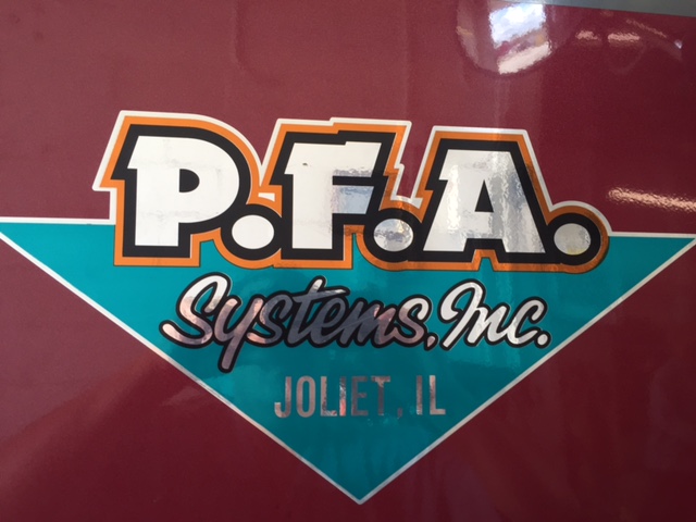

Please check out the attached pic and let me know if this is possible to accomplish on the L360. If so, what chrome vinyl and what settings should I use? Thanks in advance!

Looks like an Edge print on Smooth Silver, no idea of a chrome that would print similar on a latex, there looks to be some transparency showing through on the teal & orange area.

I have yet to find any vinyl I can't print on the 360. With correct heat settings and profiling you can almost print on anything.

Absolutely possible, with the right colour settings we printed 'Golden tickets' WIlly Wonka style very similar to a gold vinyl with chrome accents.

Your colors will be terrible, other than black, on a non-white vinyl. I would print on white, contour cut and then apply to the chrome.

I would be interested to know the settings. Whenever I have tried to print on chrome, it has always turned it a dull silver form the heat. When I tried turning the heat down, the ink just ran. I haven't had luck, but it others have, I would say it can be done. Just need the right settings.
