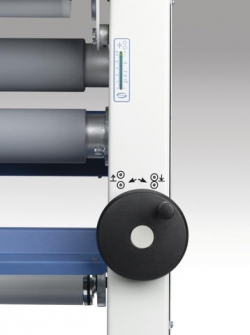

In answer to your other question > What will cause more curl is too much tension on the rollers.
If I have a Royal Sovereign, how would I control tension? It seems like it only has one setting for vinyl really, am I right?
hansman
I am not too sure on the laminators that have preset slots for pressure setting the rollers. I am thinking more of the adjustable hand crank style to set the rollers manually like the Seal 54 below.
