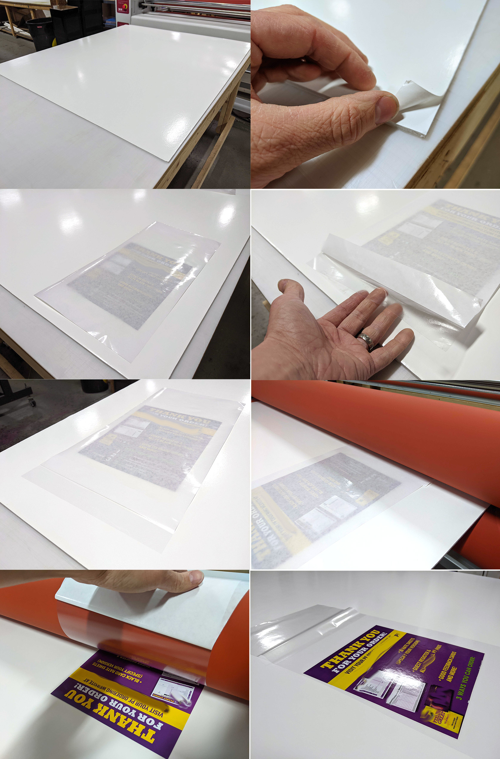

A "sled" is a piece of board with mounting adhesive applied to one side that has the release
paper left on - this make a surface that the laminate won't stick to. You put the piece of vinyl down on the sled, then take a piece of laminate cut a bit larger than your printed piece and start it was printed adhesive vinyl you were going to mount.
Here's a real quick example:
