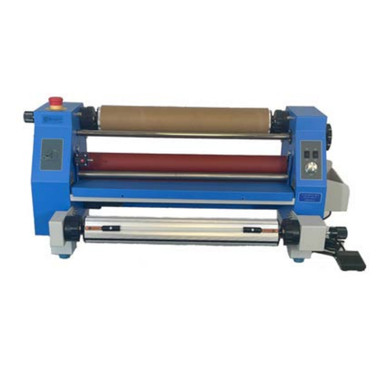

Maybe look for a used GFP 220 or other small tabletop laminator?
Not sure about 12" laminate. You'll likely need to find a supplier that can cut down rolls as jharler mentioned.
