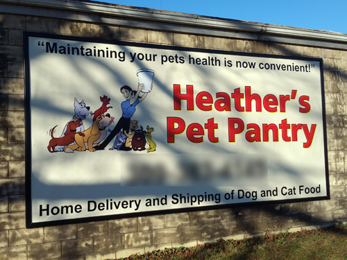

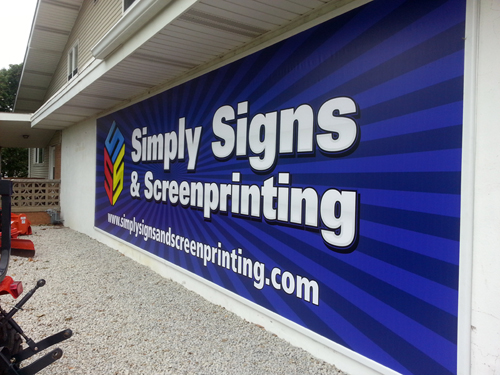

You can also order these through Grimco. The profile is about 2.5" wide and 1.5" deep. They are very easy to install and also easy to swap out banners in. They make a tool to open them that you (or your customer) will want to buy. Without it, opening them can be a struggle and you risk bending the aluminum. Because they lock so tight, I don't know if these will work well for your interior application, or not. You would probably want to hit studs on all four sides of your frame. But if you can hit studs with the top and bottom section of the frame close enough to each end you might be okay. They have an L shaped piece with set screws that lock the corners of the frame together so it might work. A call to their technical department would probably answer that question.

That's pretty nifty. Looks nice and clean. :thumb:
We've got a 40' container beside our building that I wouldn't mind doing something like this with.
The first pic I posted is of a 30' x 9' frame and the second one is a 20' x 8', I believe. These work quite well for very large banners.
