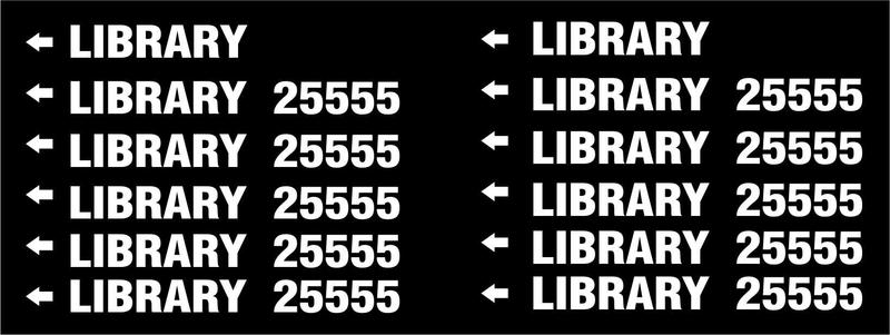

reQ
this is the sample of what needed. 36x96 black sign with engraved white, also has to be 0.5 inch thick . Still can't find any vendor. still need help

initially you said 1/16th thick. You could cut those signs separately. but if it is .5" harbor sales has a material called Colorcore that you could get someone with a router to cut out.

Yeah, their spec is 1/16 plastic (rowmark style material) mounted to 0.5 ultraboard for thickness. At the end i need 0.5" thick signs, which is black & engraved white letters
Most of the stock engravable material comes in 24"x48". Easiest way to do this sign is to laser cut 1/32 white tactile and lay it to a black ultra board.

Gotta love architects! I've asked previously if I can get rowmark material in 4'x8' sheets, I was told from our supplier that I couldn't, Rowmark doesn't make them that big (Not sure if I believe them or not)
I agree on using King Colorcore, it's already around a half inch thick, available in 4x8 sheets and engravable with a CNC router, why some architects try to reinvent the wheel I'll never know.

This is another case of someone giving specs on materials and but they don't know what they're talking about. You could replicate that sign out of several different materials. Colorcore is a very good recommendation. Using 12mm PVC and color filling is also another good recommendation. Basically my recommendation is to use logic and not let someone not in the field spec out materials for you. Using either of those materials would allow essentially anyone with a CNC to do the job.
If you insist on going based on spec, I assume you never contacted Rowmark. They would absolutely be able to help you. You could also contact Kern laser and see if they could point you in the right direction.

Its for a Government building, so they have all these specs. Talked to them 30 mins ago and told them that i talked to rowmark and that they don't make 8ft long pieces. They agreed on using something else but it still has to be engraved. Looks like ColorCore is exactly what i would need. Only thing left is to find CNC operator to do it. Or maybe anyone know place that does wholesale work & keeps that material in stock? Located in Canada of course :)

Government don't have the right specs. I deal with municipalities all the time. They are absolutely clueless for the most part.
Colorcore is heavy stuff. You're going to want to find someone local to do it. Literally anyone with a 4x8 CNC should be able to do the job. Centurion tools makes a specific cutter for Colorcore. You can also use a regular endmill or V-bit.
