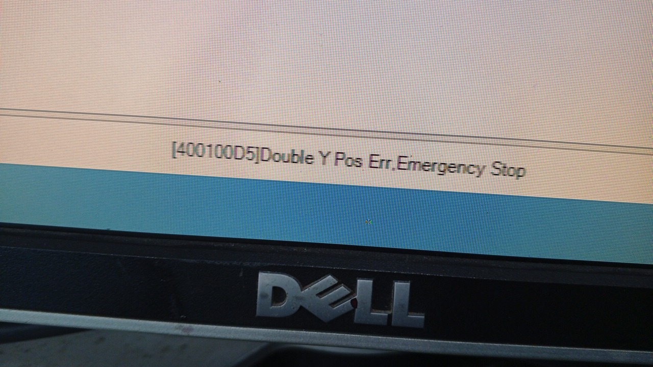

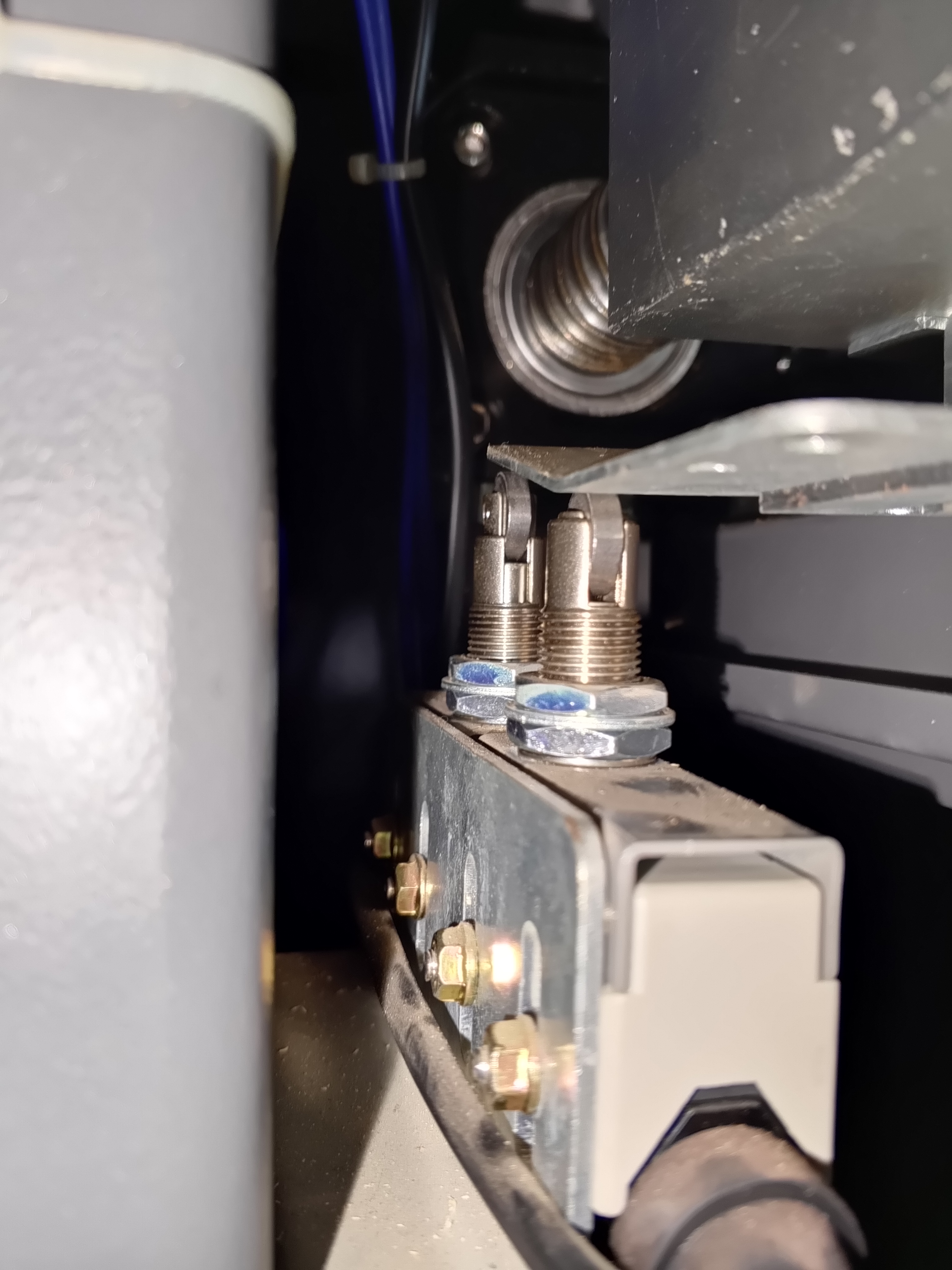

my problem is when I turn on the machine on the self test , the X,Z works fine but on Y it gives direct error and not moving.I checked all the limit sensors and emergency sensors all working fine.

I tested everything single wire and the 2 Y's motor has power , if you try to turn it by hand it wont move and the encoder reading good according to the servo motor controller display screen, but still not moving , I checked all the Limit switch's all are fine

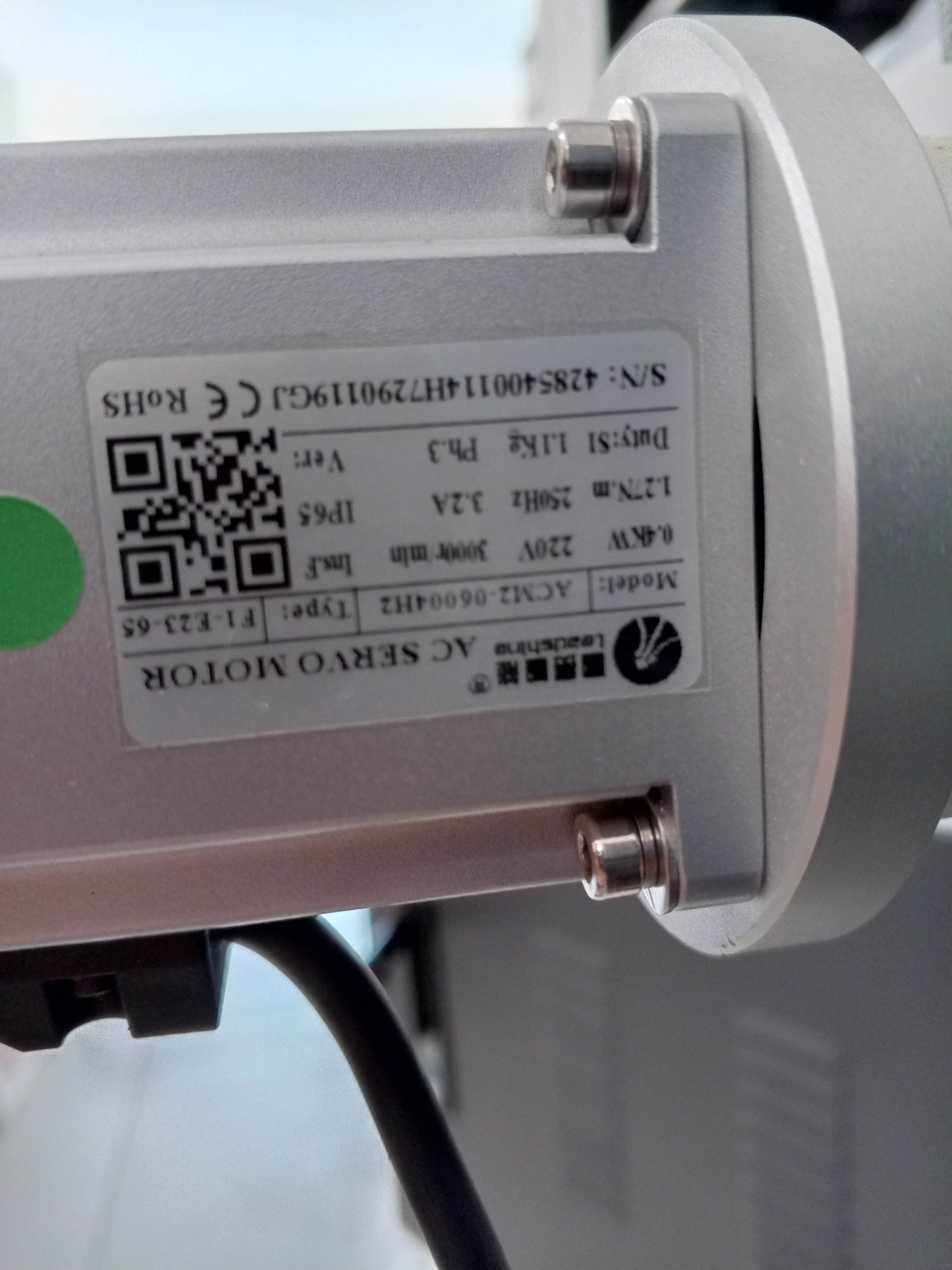

If the machine is OFF the motors turn very smoothly by hand no load at all .

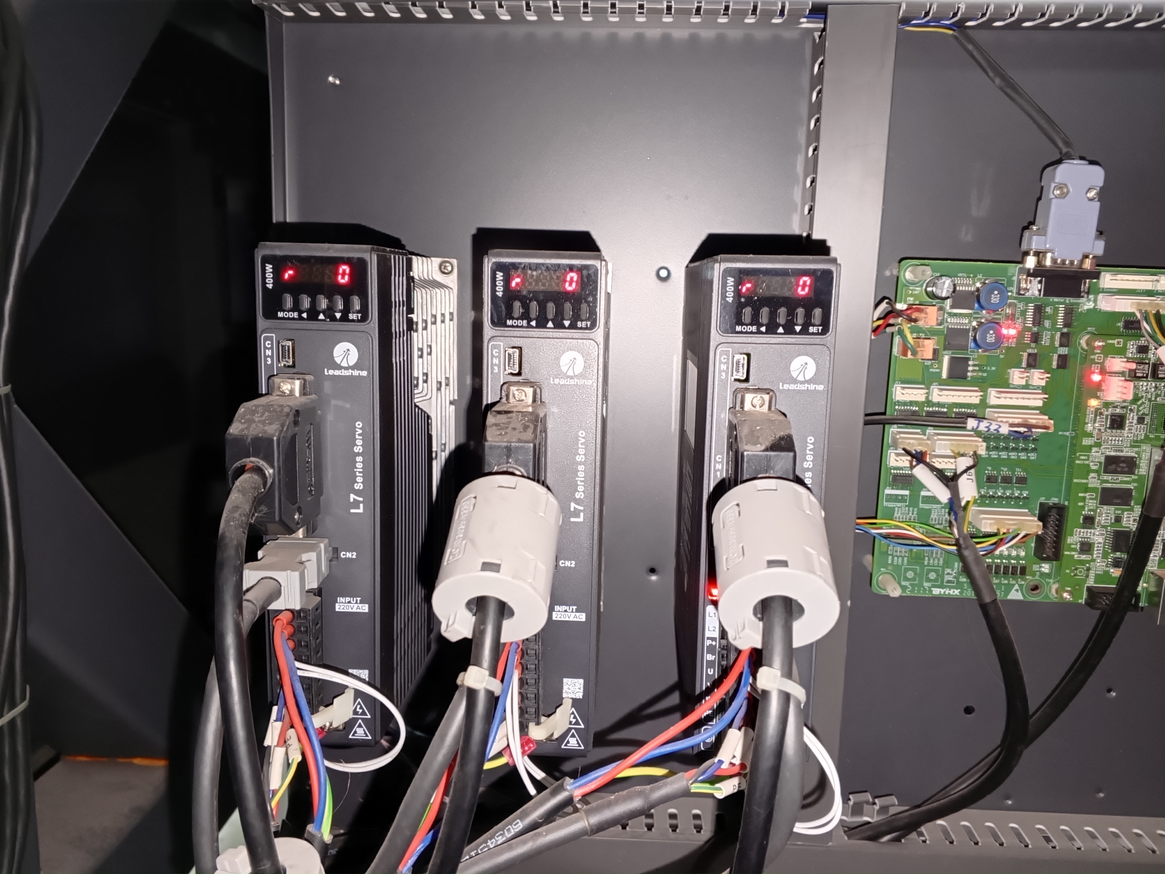

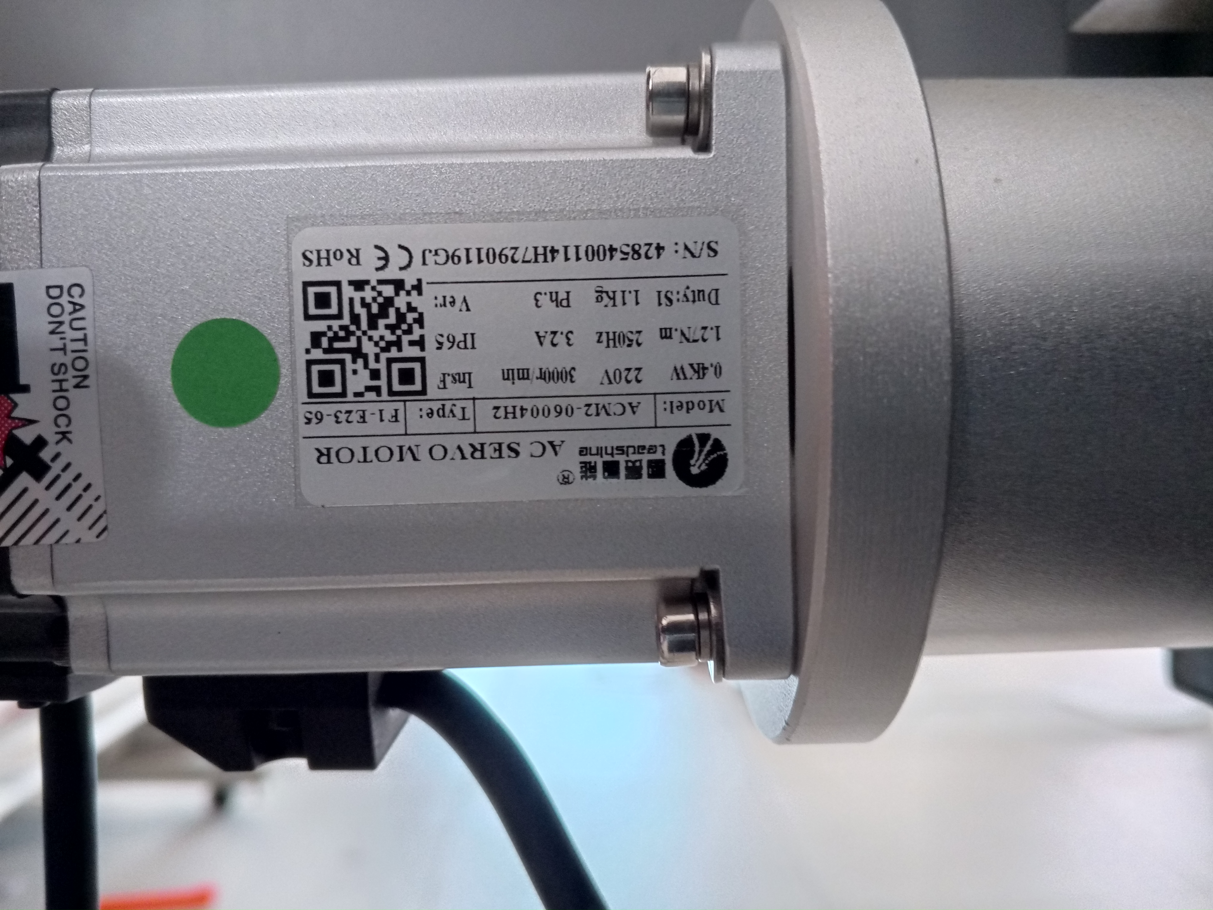

I will attach a Photo for the motors and the control server for the motors its Y left , Y right , X .
if I turn the Y by hand the control display numbers change

Smoke_Jaguar
Looks like pretty decent parts in the machine, copies of higher end gear, but still quite decent. Here's a video that shows how to do a jog/test on the servo.
If the servo jogs fine, check the wiring to the driver.

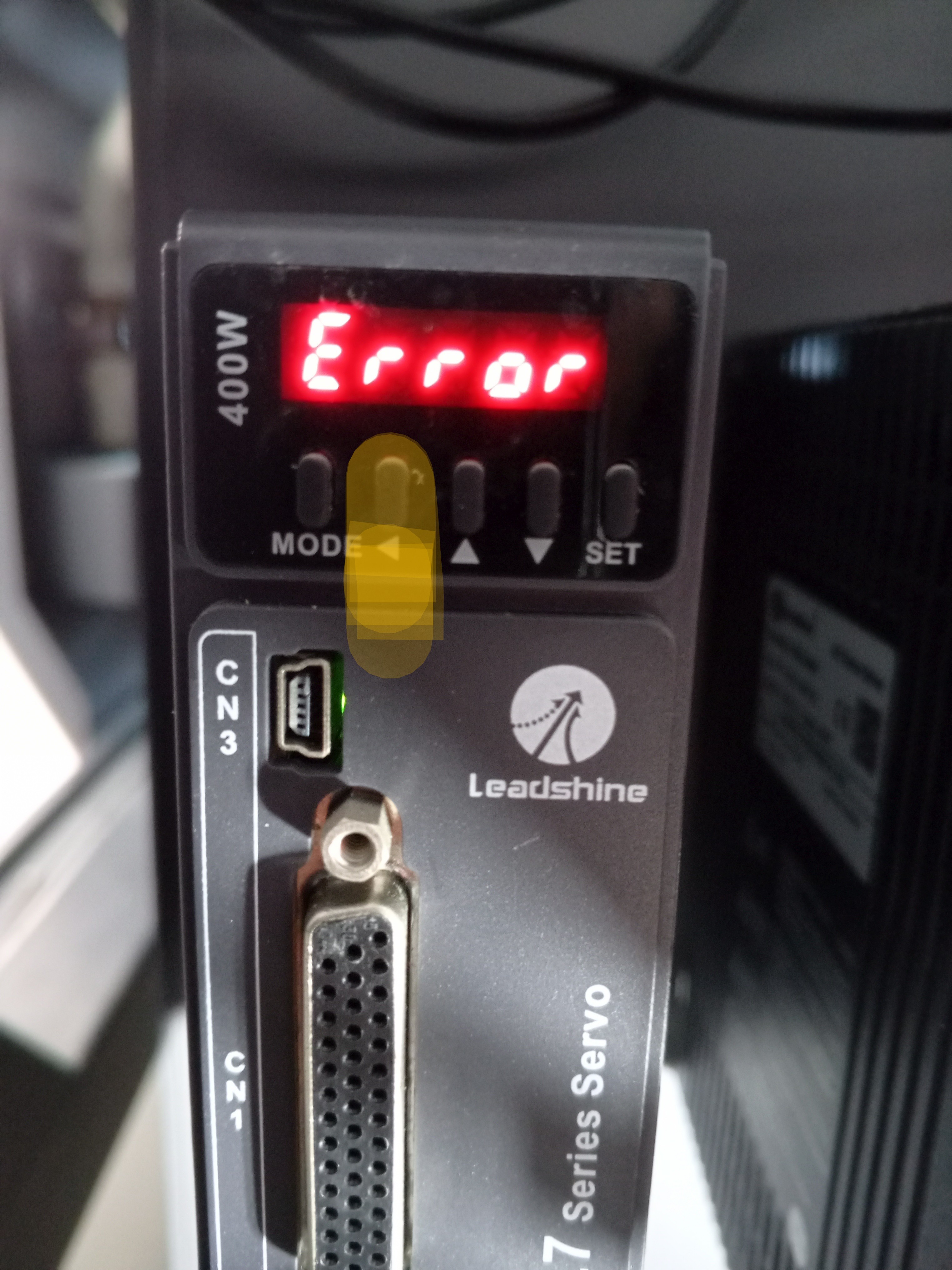

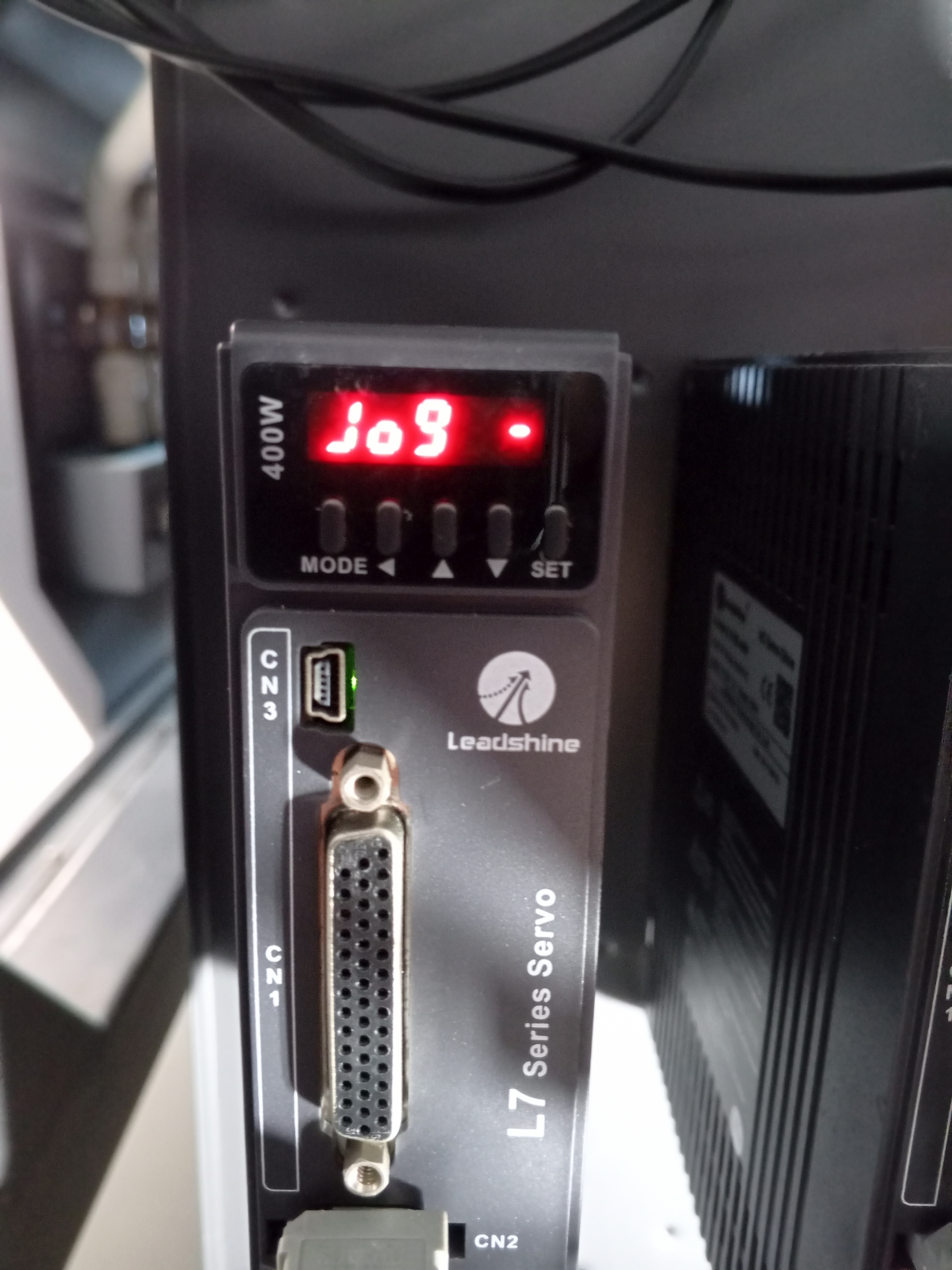

Chrb
I tried the Log test but i got an error after press the button to lock the motor .

Smoke_Jaguar
Check the wiring from the controller to the servo. Might be a bad servo or a wire lug cameoose. Or potentially controller issues.
Smoke_Jaguar
Might need to try and find a manual for the stepper driver, some require different modes to do jog tests.

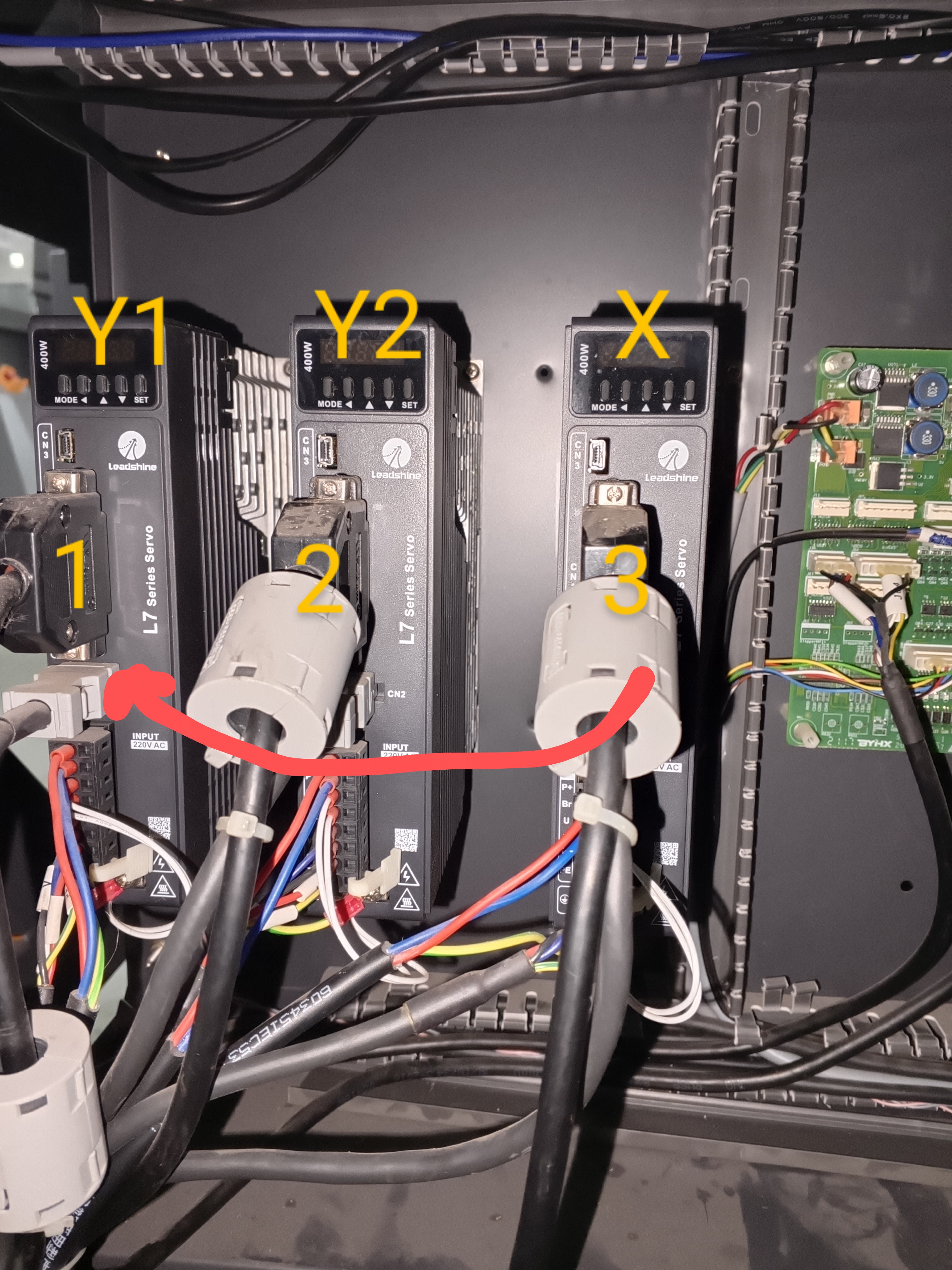

I restart many times and I changed the computer also same problem.
I removed one of the Y motors and connected to the X cables , it turns normally then I reconnected it to the Y L7 driver didn't work .
I removed the X motor cable connector from the drive and plugged it in the Y1 drive and turn on the machine the motor turns.
I attached photo to explain.
I think there's problem in the main board, I suggestions.

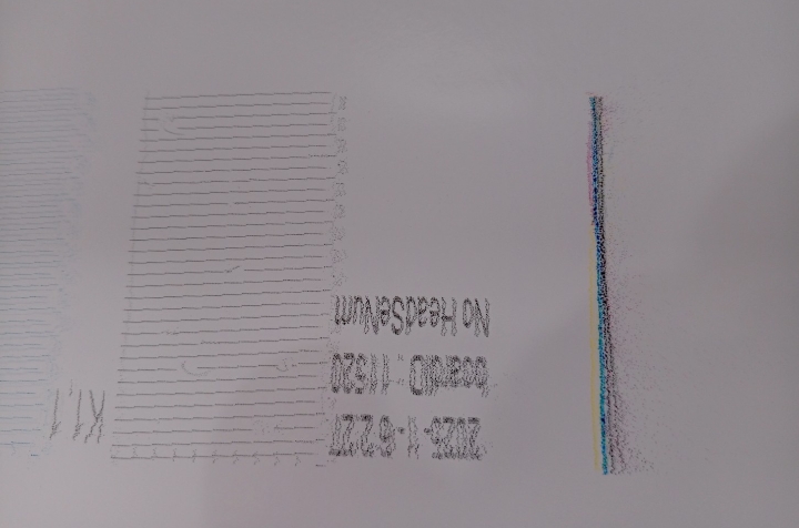

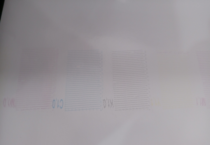

Hello everyone,

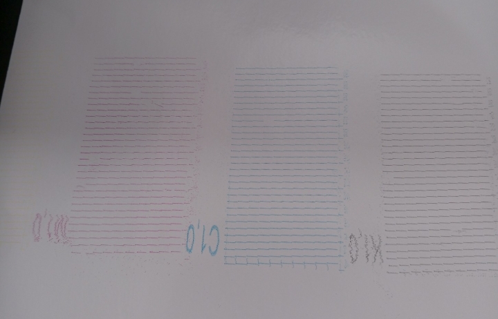

I managed to print on the machine without connecting the Y axis encoder cables , the machine run normally,but now I have a problem with nozzle check, does anybody knows why it prints like this, see attached

amandaveronica
Hello everyone,
No idea if this might help… I’m trying to remember, but I think for me it was the encoder reader??? And if you can get it to do a print test then it’s obviously moving Y.. but goofy, have you cleaned it?
I had one time it just won’t move Y at all.. and just needed to wiggle the cable connected to the encoder reader..
Either that or it was the fiber optic cable..
Either one it was always a wire connection going bad or “crimped” too hard.
Chrb
Thank you Sir for your reply.
The problem is, if I connect any Y axe side to the X servo motor controller it works , the motor moves but of course on one side, so the cables are ok.
and regarding the bad test print I might change the fiber cable from the main board to the carriage board, I hope it will work.
