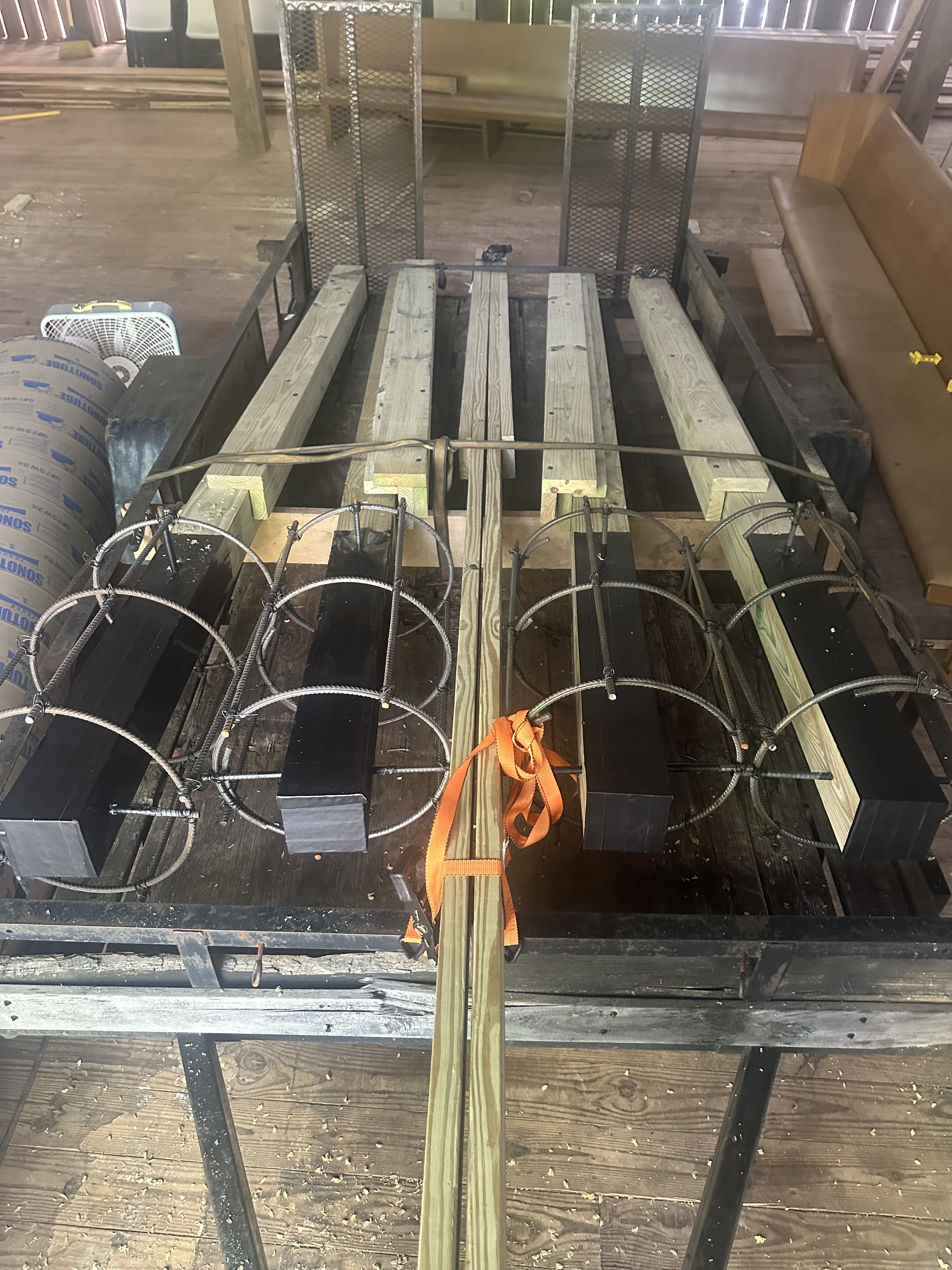

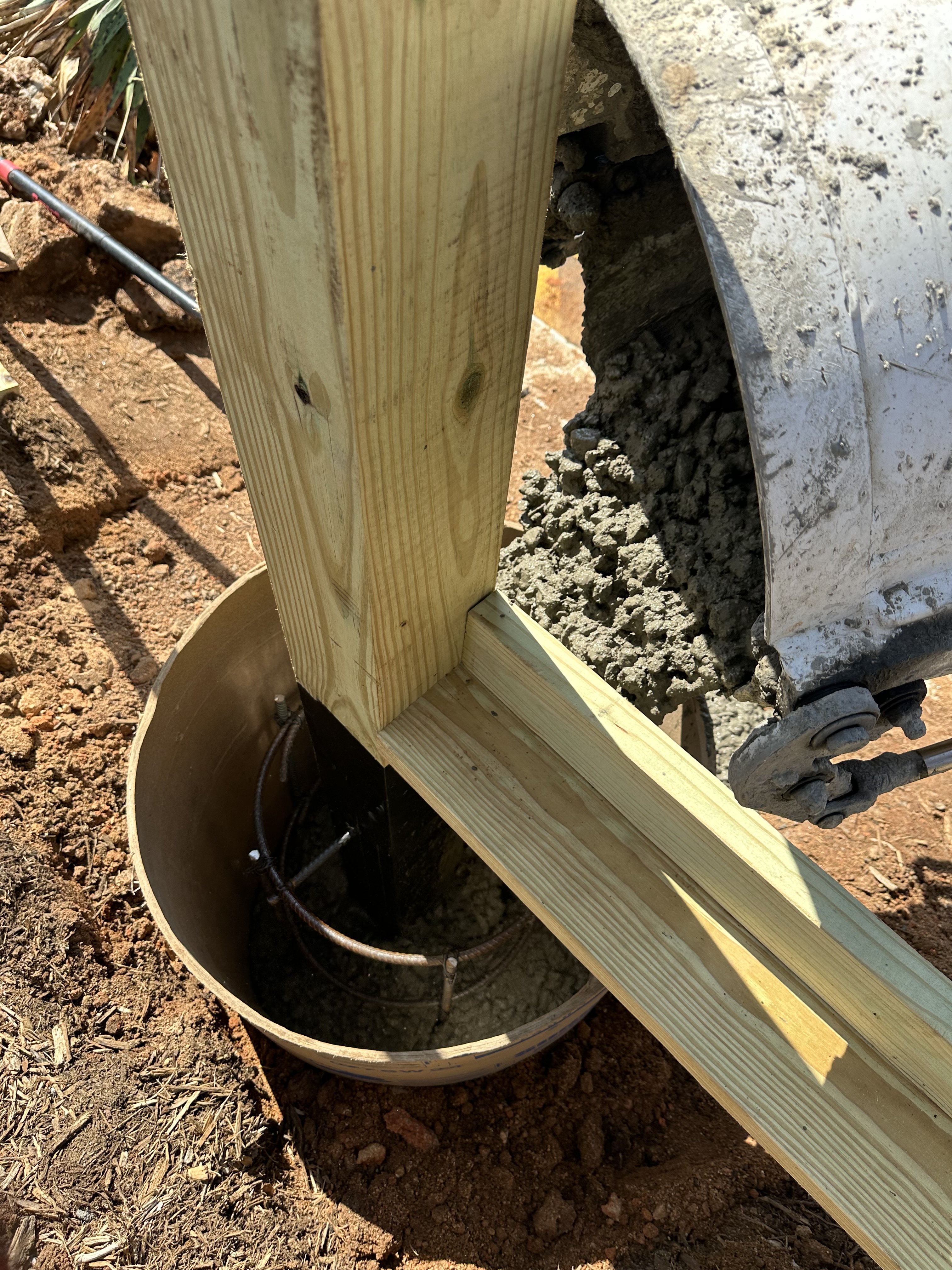

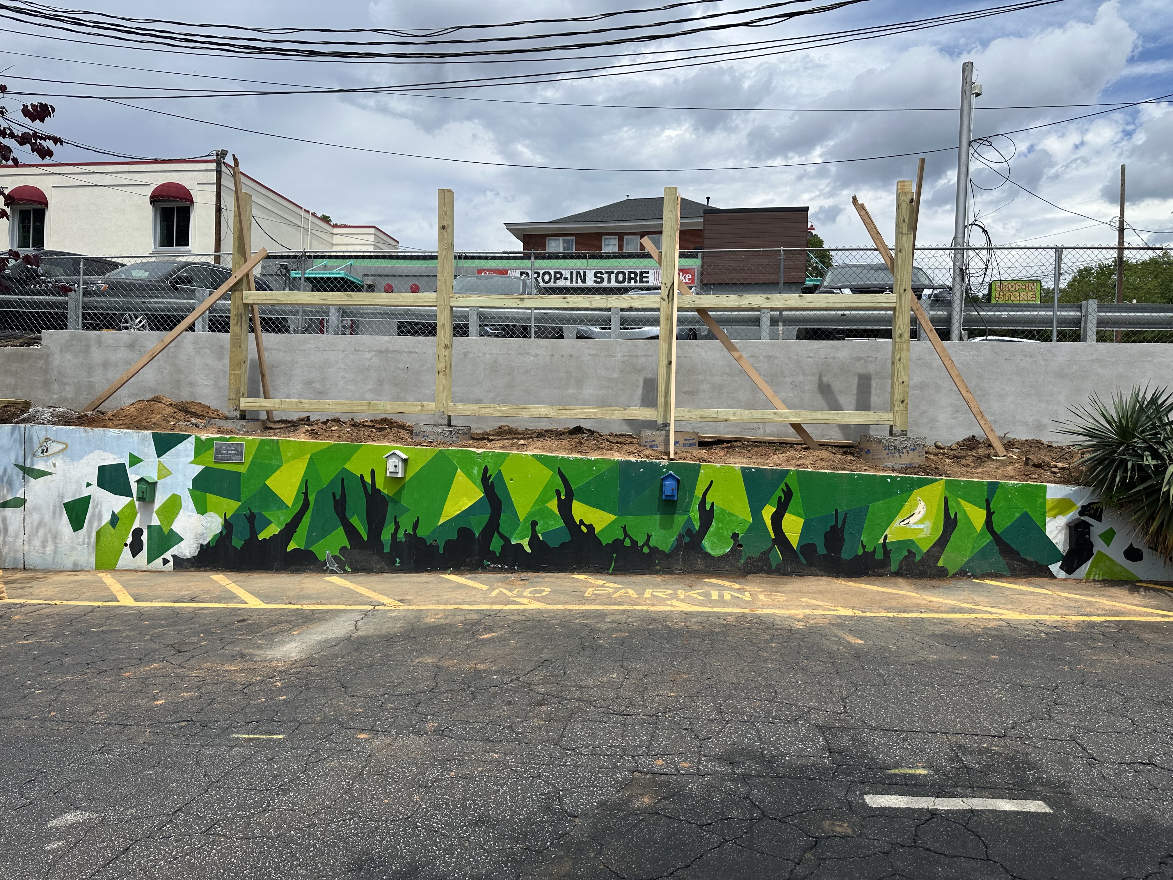

*Update:
I looked at all the options and I’m going with my original design. Galvanized steel square tubing was out of the clients budget. Aluminum forget it. I designed this frame as best as I could to serve the client well, be as cost effective as I can, and make the mural last as long as possible under the circumstances.
I integrated the rebar cages into the 6x6 butyl tape wrapped posts. All four are set into 24”x48” sonotubes. I’ve excavated the dirt, imported good o’le South Carolina red clay for the best compaction. I’ve braced the 6x6 beams with 2x6 strong backs that act as both torsion prevention and fastener support for the mural panels. 4000 psi concrete was just poured in the holes today and the frame is nearly ready for mounting the mural.
I need to bolt the top laminated beam I made to the posts once concrete has set and then bolt/structural screw the mural panels to the frame. I’ll add some cedar post base trim around the bottom where the butyl tape is exposed at the footer and paint the concrete to blend it a bit better.
Overall, I know it’s not the perfect steel post mural frame that would be ideal but I think it’ll outlast me and the shop owner. The end result is an iconic memorial to some local musicians will be restored and I’m happy to have had a hand in it! Mural panels go up in five days and the artist gets to work the next day!
