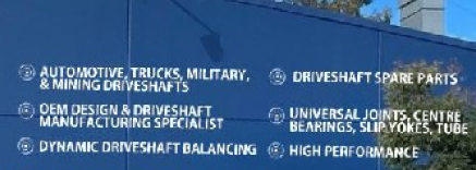

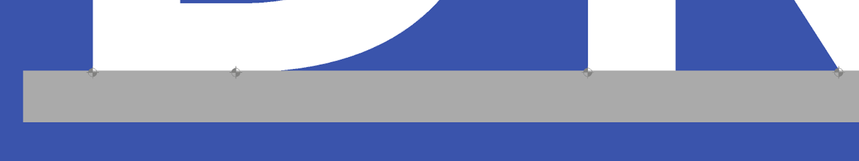

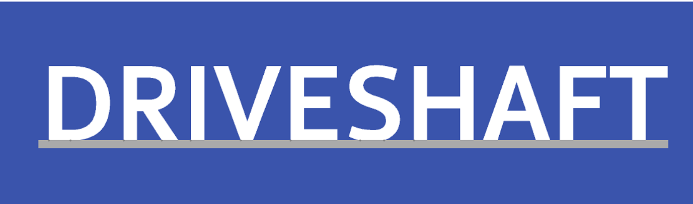

Just looking to get some advise on getting this installed on to a large industrial shed. Its large like 5 meters each section cut letting out of ACM. We initially thought a template out of backing paper but given the length this is proving hard to handle once its weeded to handle.
We will be working from height. I am sure there is a better way to get this on the wall just looking to see how you guys might tackle it ?
