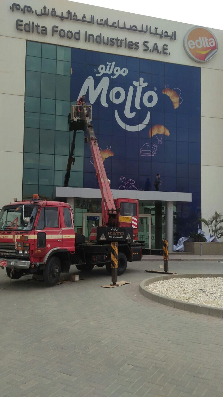

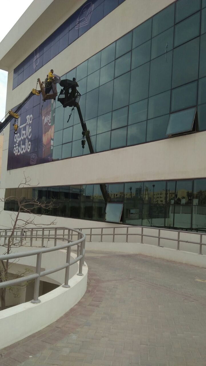

Ahmed Samy Nagada
It's ok to do that without overlaminate, follow (Texas Signmaker) steps, and all would be fine. Picture attached was done without overlaminate.
