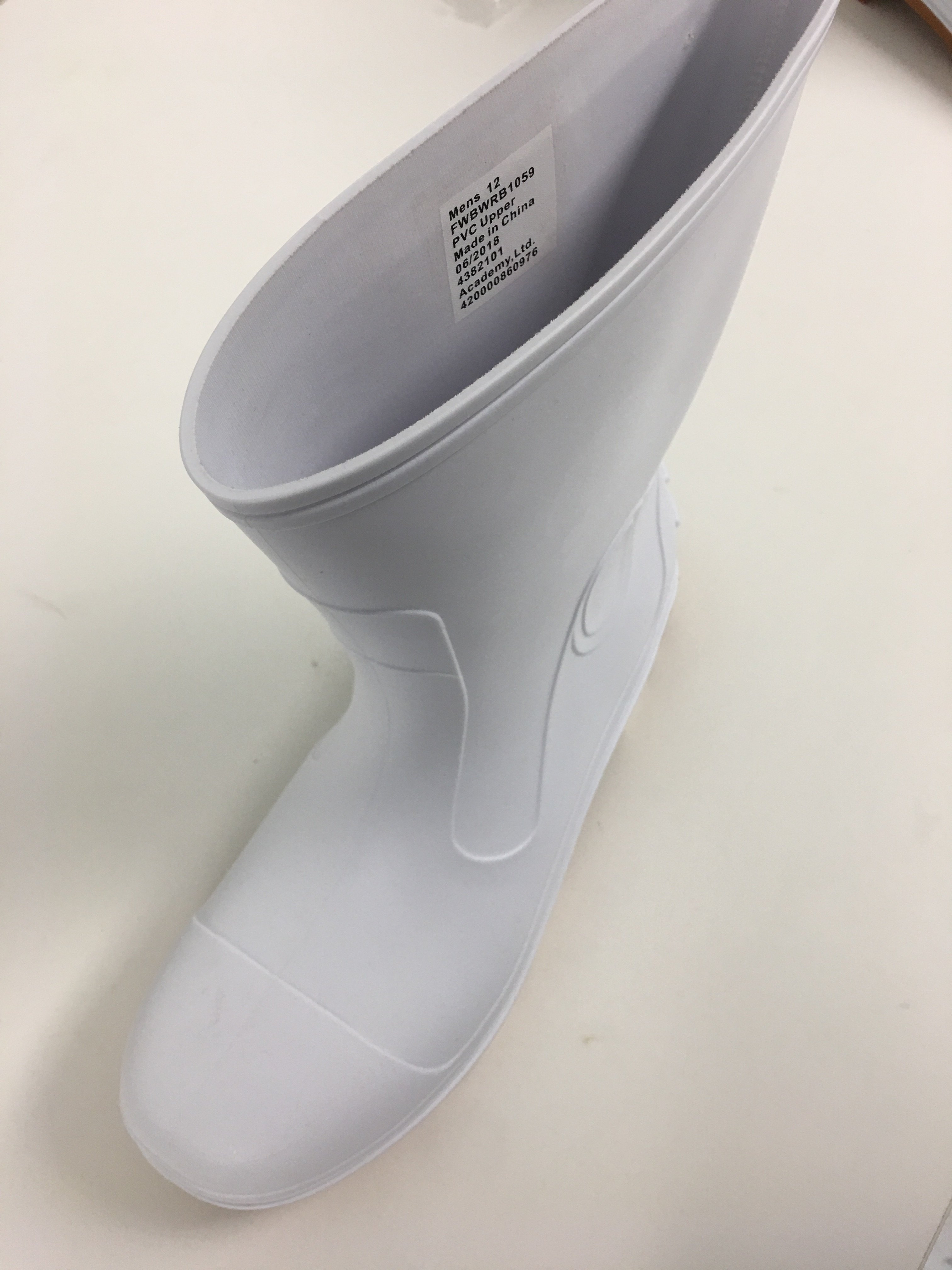

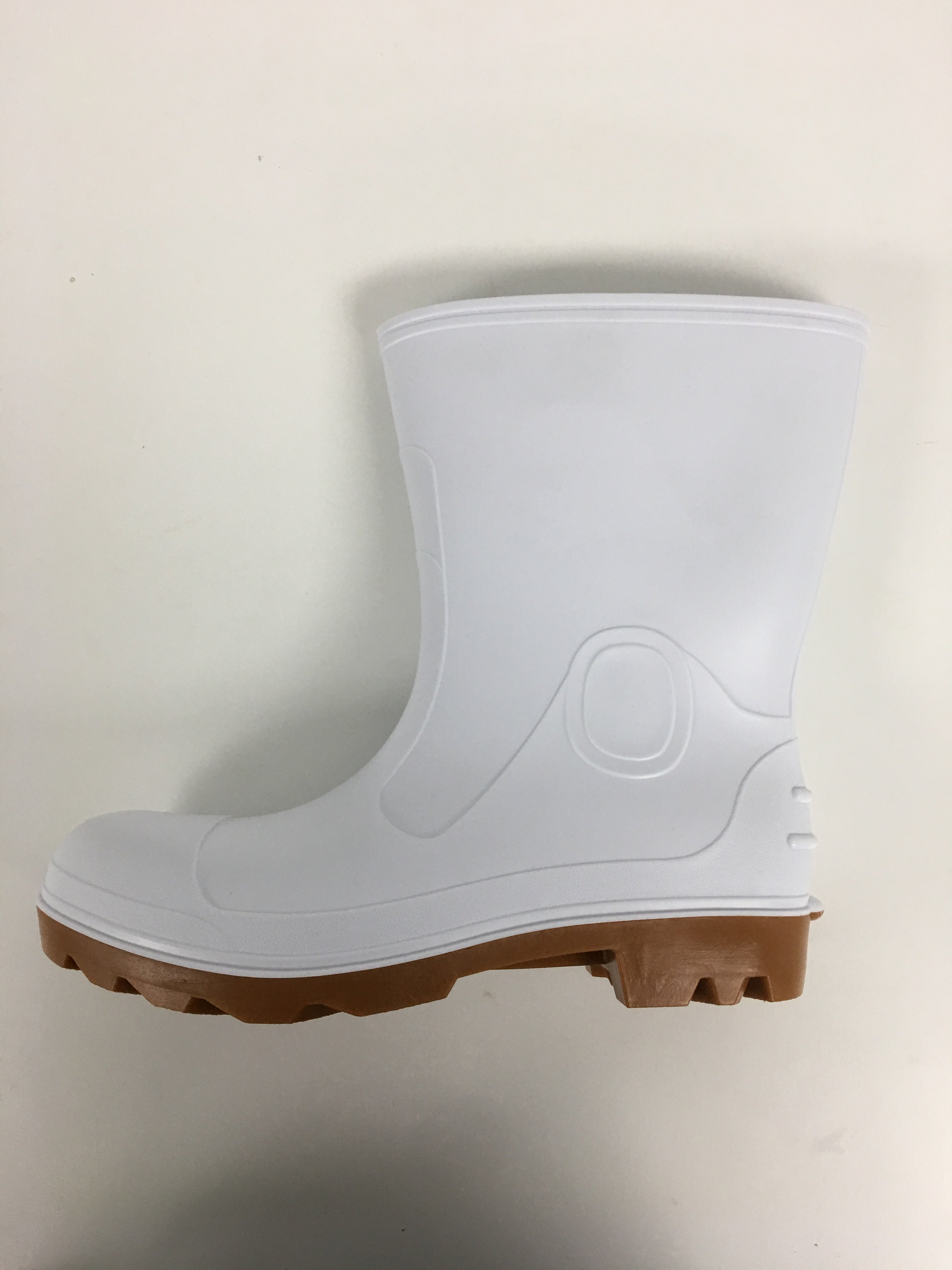

We are looking to customize some shrimp boots with a relatively small logo -- 3" x 4"
We have tried applying vinyl and screen printing and neither have stuck. We are thinking our next step is laser engraving the rubber. Does anyone have experience or advice on this? We are open to other methods as well.
Images of boots are attached.
Thank you!

Thank you for the info. Any ideas for alternatives than the laser? The screen printing ink would not stick.
d fleming
How many boots? Maybe you should send it out of area and have it done with proper inkset if the run quantity justifies it.
SheBeau
Depending on how complicated the logo is and how many you’re doing, it may be as simple as cutting a vinyl stencil and using Sipa Paint Markers (or similar). They’re permanent color on rubber.
