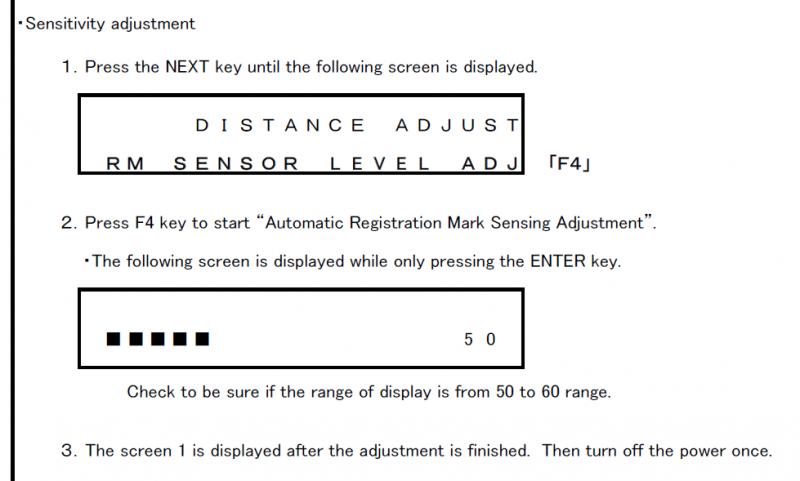

recalibrate
You should not have to put tape or anything on the reg marks just recalibrate the arm's system I had the same problem I recalibrated and it finds them every time now.
Load piece of media in the cutter (white unprinted) (or what ever type you intend on cutting)
Turn on the cutter holding the test and enter keys down (service mode)
After it boots up release the keys
Now press menu key and then next key until you see RM SENSOR LEVEL ADJ and press F4
You may need to hit enter again but it will do a auto adjust scan (it is very fast you will see bars going across the display screen).
After its done turn the cutter off and back on again and give it a try see if it works better
Please note that if you cutter is near a window and you do the calibration during the day you may have problems at night.
The best thing to do is to calibrate it in the same lighting conditions that you intend on using it in.
Also lets say if you calibrate it and then a week later move the cutter to a new location in your shop I would recalibrate it again being the lighting conditions have changed.
If you calibrate lets say white laminated media and it works for you and then you want to cut reflective media I would recalibrate with reflective media before attempting any cuts as the lighting conditions have changed because of the nature of the reflective media.
